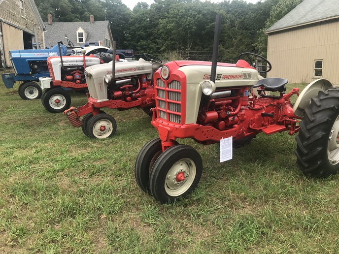

How is this? third party image
You should be able to see the clips along the top edge of the transmission that hold the black wire loom and the clips that hold the wire loom to the brake rod in front of the axle.
