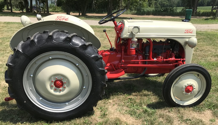

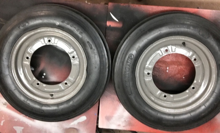

Those front hubs are not 8N though. They are earlier 9N/2N hubs.
I don't believe that makes a difference on your seals, but the bolt
pattern on the 8N hubs and rims were 6 bolt and far smaller.
8N I just finished.
9N 16 inch rims
My old 9N. Notice the rear rim/hub difference from an 8N.
8N I just finished.
9N 16 inch rims
