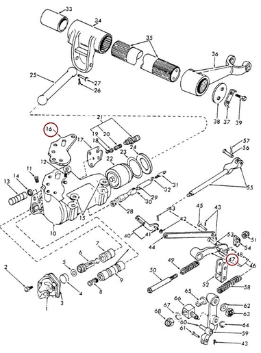

Ultradog MN, I couldn't find the item Cam Follower Pin & Lift cylinder seal in my MPC. Are they part of the Lift cylinder, shaft & related parts ?
I'm not UD but are [b:7a6ca4dcc7]items 16 & 47[/b:7a6ca4dcc7] what you're looking for?
I'm wondering too. Items 16 & 47 in which book ? Maybe I'm looking in the wrong places, but I can't find those mentioned in any of my four manuals.

The link I provided "Items 16 & 47" is the New Holland online parts page for the NAA.
Sorry, I forgot to post the image:
On your cam follower pin; a standard 5/16" X 1" dowel pin will work but is .003 larger in diameter and may have to be beveled to install it. Or if dowel pin previously installed or the hole is oversized, no grinding required.

Item 47 in your NH parts book appears to be item 73298-S18
in my 53-59 MPC, except mine lists it as 5/16 x 7/8.
Anyway thank you for looking it up. I couldn't figure out what it was by the previous descriptions. IF I take the cover off I'll then see what it's condition is and go from there.
