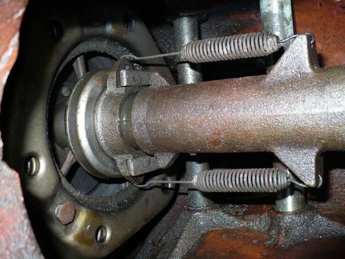

Can you photograph the installed release bearing?
Just for grins - Place a straight edge across the face of the bell housing and measure the distance to the release bearing. Then measure the distance from the engine block to the installed height of the pressure plate levers and compare those two numbers.
Or, pull the steering box and view the release bearing to pressure plate arrangement as shown below.
Clutch Pedal Depressed
Thanks dollar bill! When I measured it I got 1 7/8ths for the measurement. It’s not 2 inches like it’s supposed to be but it’s non adjustable. I’m going to remove the steering box to view it better when I get it back together.

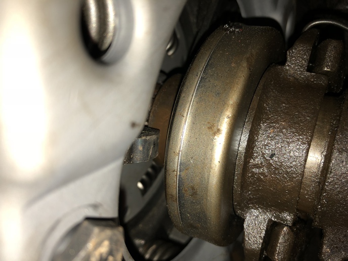

Here it is adjusted to the max with the pedal not depressed

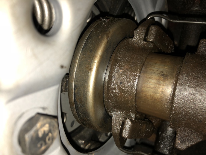

This is it with the pedal depressed as far as it could go through the floorboard.
Does the fork look like it should in this picture?

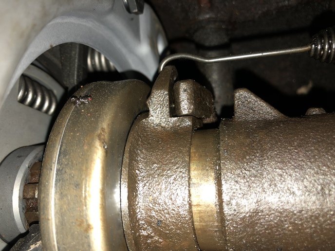

Here are some more...
Are you absolutely positive the release fork is hatched to the cross shaft solid... I would set out to prove the fork is not moving on the cross shaft....

Does the re!ease bearing move proportionally with pressing the clutch pedal?
There appears to be too much clearance between release bearing and pressure plate levers when clutch is released.
