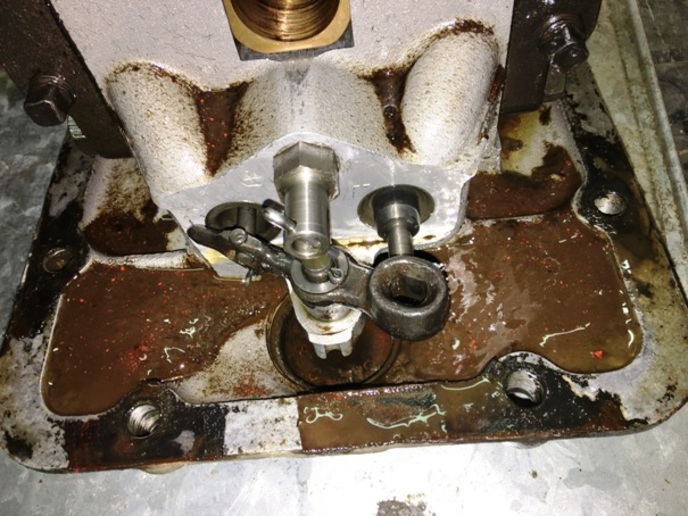

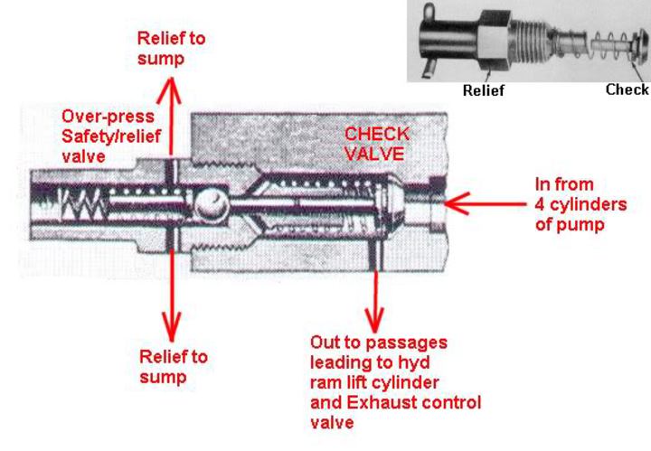

Quoting Removed, click Modern View to see
Have never had one apart but according to this photo, you seem to be missing the plunger that goes between the spring and safety/relief ball valve.
third party image
The control valves are spring loaded too

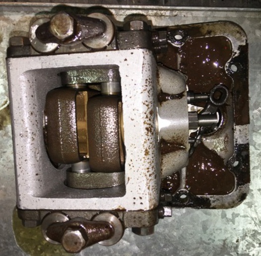

Quick question...so while removing the safety valve today I noticed the cotter key in the end of it was going to hit the control arm below it, so being that I am replacing the valve anyways I proceeded to just pull the pin out for clearance. What I didn't expect was a projectile to come shooting into my chest and onto the floor. I'm pretty confident I recovered all the pieces but I figured just to be safe I better ask. Be a pisser to get it all back together only to have some loose part foil the whole job (see photo).
And before I pull the intake/exhaust valves in an effort to clean those, is there anything else I might need to be aware of :shock: ?
As others advised, it's best to bite the bullet and give it a thorough cleaning. It will give you better access to pull the lift cover as well as the pump.
If you're under a time crunch, I would follow Soundguy's method:
Drain oil overnight and add 3 gals kerosene, 2 qts ATF, 4 pints 90% rubbing alcohol. Cycle the hydraulics once then exhaust to clear anything in the pump that might be hanging around. Disengage the PTO and make a few low speed laps around driveway. Then drain and refill with new oil.
Theory is the kerosene makes it dump fast and dissolve most emulsion it finds. The detergents in the ATF will suspend any crud it can and the alcohol will evaporate any water in the system.
[Log in to Reply]  [No Email]
Jim WI
02-08-2018 16:19:41
Report to Moderator
 Re: Swapping PTO Soon in reply to mcharley94, 02-08-2018 16:10:46
On my 8N, the sludge was thick that I could see a groove where the control valve moved back and forth. We had to take the top cover off anyway since the control rod was bent in a curve. Once we did that, my son and I decided that it would not be much more work to drop the pump. I'm glad I did as it was much easier to get the sludge out of the rest of the compartments with the PTO and pump both removed.
It may depend on how bad the sludge is.
Den N Ms
02-08-2018 16:18:34
Report to Moderator
Mcharley94,If there is a bunch of sludge in there it is best to drop the pump and get it all cleaned out. Do it right one time and not have to do it again next year.
