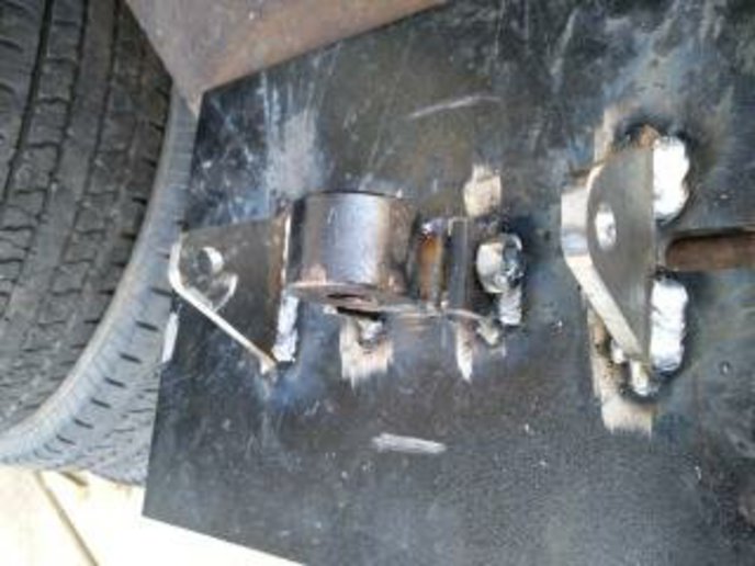

More more more
It has 15 degrees of tilt more than you would need on a transmission jack but what I would think what you would be shooting for...
third party image
Lets talk about this little devil its not a stop its a bushing I originally tacked welded it in place as I moved on and kept modifying and drilling holes in the top to add/bolt stuff to I pined it to the rod because the adjuster rod has to come out the threads are larger then the rod... The other end is captured you will see this in the pix's...

OK belly full and newspaper read...
The board on top will be your seat bracket.
I added a extra plate to the top one 1/4 plate is not strong enoufh for a heavy trans it needs to be 3/8" at the least. I made the brackets to fit the oil pan also some are pointed down just for storage one is up for the pix... I forgot to angle it and get a pix may just do'dat...
Pix 4 shows the original rollers the top slid on it would move left to right but not tilt :(

A modification I did to a new transmission jack I brought it tilts front to back but not left to right. This is the tilt function I added to it to be able to tilt front to back and side to side. I will try and get a pix of the complete assy later today. In my case it added no additional height but would add 2 to 2 1/2" to a N seat. It would be adjustable with a threaded rod :)...
If any of y'all have a transmission jack that only adjust one way this will make it adjustable both ways. This is my first one so I had to guess and sim on the center piece it works great.... Why the manufacture did not add this I dunno, its a must have on a transmission jack in my opinion. third party image third party image third party image third party image
Weld are bolt Mount original seat mount to a (guess) 10X10 1/4" steel plate the original bracket inline with the 2 triangle pieces in the pix, add a couple short pieces to each side of the plat so you cab run threaded rod thru the shorts and thu the center adjuster on the plate. You are done :) how technical you want to get on the slop is your call this one rocks very little that's because I allowed for some slop in the center rocker so it would be free and not in a bind. After doing this I could nail the next one rat damm close... That short piece of pipe on the bottom of the center rocker it the BIG TIP it allows the center rocker to float as you adjust it...
If height is a problem you don't have to use the original seat spring :wink:

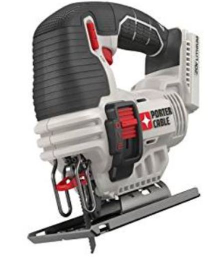

Kirk, you're a good fabricator. How about using 2" pipe with slots like the tilting base on a jig saw?
third party image
And there's also the worn out Rest-O-Ride seat option :)
