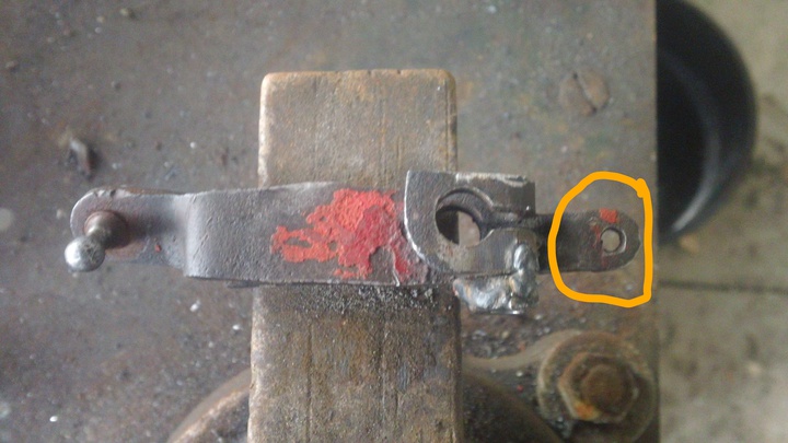

I have already fixed the poor construction; knob for linkage to big for linkage ends have ground down to fit; penetrating lock-tight in the sleeve for proof cable.
Sims are ok, the balls are the same weight.
I need to know what the measurement is for the bend of the throttle arm "long one" not the linkage, but the arm on the governor.

Several times I have seen people connect the throttle rod to the wrong governor lever. The one with the spring is the one to connect to. Carb goes to
the little sort lever.

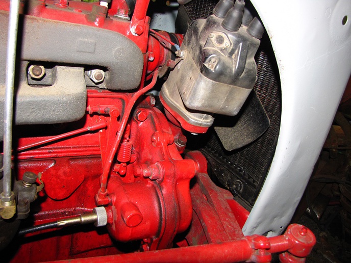

Looks close front distributor and coil flush mounted, were is your generator or alt.
Do you have a pic of the throttle end below the dash, may be that were my problem is.
(quoted from post at 22:19:49 01/12/18)
The picture is of my 8n with a magneto, side mount block. Alternator is on other side. It was an industrial engine that PO installed. I will get a picture of below the dash later when I can.
Here's a picture of mine. Shiny part in front is the proofmeter
cable. Governor compensating spring below the linkage.
Thanx for the pic.
What function does that throttle compensating spring provide, I do not have one, never did, could that have my problem all along???

Mine when I did not have the spring the throttle lever would not stay up, the gov would push the lever down. That is why it is called the governor compensating spring.
Disconnect the end at the governor, the one from the front hand throttle and make sure it moves fairly easy. should really only feel the bumps on the plate.

I have two books, one older than the other, the older book highlights the "jig part #ELO7691 with the a gauge to measure the carb. arm. Then put it on the jig to bend with a hammer for the correct angle.
The new book says to bend the linkage like you suggested, and I have tried that, bending it almost to a 90* still has not worked.

There should be no bending of the linkage on an 8N, that is for the 9n and 2n. I think that the bending of the arm as shown in the old book was replaced by bending the tangs on the spring to achieve the same thing. good luck
I constructed a new linkage out of all thread for the carburetor to the shorter arm on governor, hoping that it would give about two inches of adjustment.

Look at the picture I posted. You will see an oil line going to the back of the governor. It is the rod coming from the throttle lever that you adjust not he short one going to the carb.

I have already fixed the no governing part of my problem, Throttle control rod end where the spring attaches was hitting the steering box which kept it from going to min. bent it up
I made new shorter rod out of all thread for the linkage from the governor to the carb. the old rod you could bend only so far, before the geometry would go out wack.
