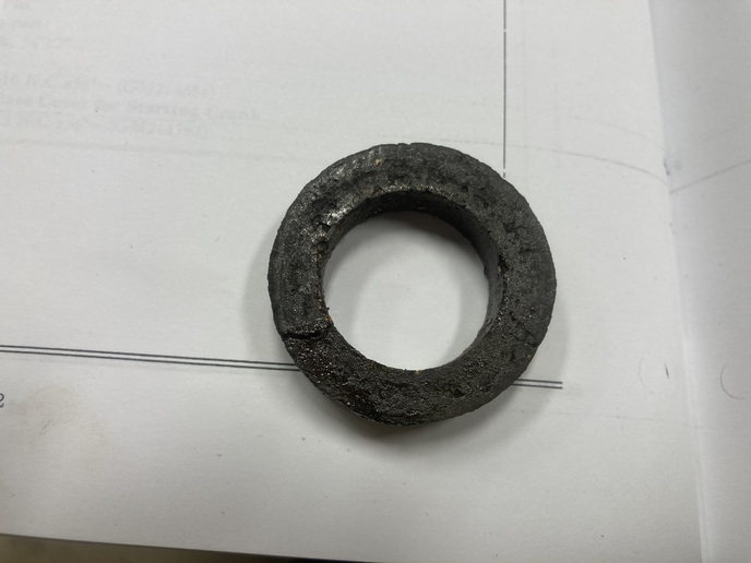

Im looking for the cork washer that goes on the steering shaft on a RTI part number Rt9553A. Does anyone know a supplier that would carry this? Thanks,Mark

Same part# as the one for the Ross steering box on my ZAS, described as a cork washer. I have done some research and found CR (Chicago Rawhide) seals the same OD (1 5/8) and ID (1). #9934 is single lip and 9935 is double lip. These will do a much better job of keeping water out than cork and I plan to fit a 9935 seal to mine. Thickness is a little less so a simple cork shim under the seal should do the job. A local supplier lists them for 11 bucks or so. Just my 2 cents.....
