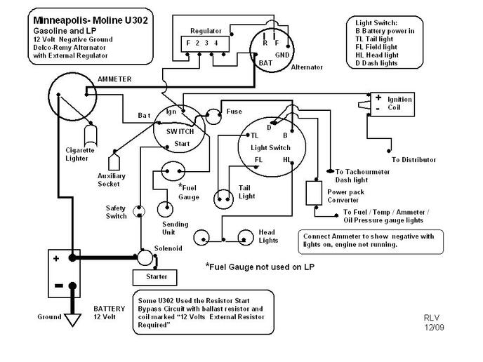

I am trying to find a electrical diagram for a Moline U302 gas. The wiring on the one that I am working on is all buggered up. Anybody have one they could scan and send to my e-mail. My e-mail is open. Thanks

 Re: Need A Wiring Diagram For A U302 Gas in reply to KCTractors, 06-22-2023 10:58:49
I sent the one I had because it pretty accurate. I wonder how many versions there were. I have one with a Generator which is about the same and one with the hot wire to the coil from starter for extra spark when starting. Also I think our early U-302 and later 1966 Super U-302 had the power pack on for neon dash lights but they been un-hooked & Probably don't work. I thought the M-602 diagram was better except they had Positive ground Generator and mine has a push button start. Lots of changes in them few years of production??Cleddy

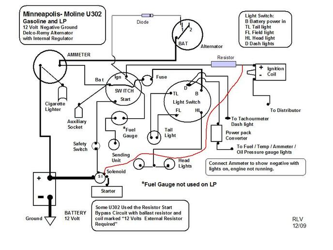

I use schematic in M670S or G1000 operator manual. Is better than block diagram as has color codes and basically the same as 302 and Jet 3 S.
Thank you rvigil-KS and cleddy, that is what I needed!
Here's one for Delco internal regulated alternator
Hope this works I saved it off computer some time ago. Cleddy
