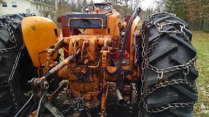

I have a 1958 445 that leaks profusely out of the power steering relief valve (on the pump not the damper valve up front). I have removed it, cleaning it and inspected the internal seat as well as I can. I've also examined the pump closely for cracks but nothing is evident. I'd like to remove the pump for further inspection and a possible rebuild but I'm not sure if there are any pitfalls when doing that. Is there anyone out there that can coach me on removing it. I have the shop manual but the instructions are very vague. I believe it's known as a Webster pump and the model is #10A8010.
Also I'm wondering if I'm looking at a weak valve spring but don't know how to test it. The manual says it should read 31.5-38.5 lbs. when compressed to 1 3/4". It looks good other than minor wear on one side but could still be weak. Any guidance will be appreciated. :?:

Im sure you already know this but there is supposed to be an O ring on the plug if it is a regular hydraulic pump. Can you post a picture of the pump?
Here are pictures of the pump on the 445 and the model number tag. I've also included the pump blowup from the shop manual. It doesn't show an O ring between the plug (#7) and the pump body. Virtually all blowups in the manual show O rings where they are required. I feel I would change the cracking pressure if I added an O ring under the plug because it is set with shims inside the barrel of the plug. That's why I am suspicious of the valve spring compression pressure being weakened. Any thoughts?
The spring isn't your problem.
Unless low hydraulic bypass pressure is suspected/confirmed there's no reason to worry about it.
I checked the Agco parts lookup and there's NO o-ring or seal ring shown on the relief "plug".
That tells me thread sealant must have been originally used.
Did you use any?
I would clean the internal and external threads with BrakeKleen, allow to air dry, then install the plug with some good thread sealant.
(To get things reasonably oil-free with the pump in place you may have to drain the oil, as well as leave the plug out of the pump for a couple of days while oil in the pump drains out.)
That should fix the problem UNLESS the case is cracked.
THANKS! That seems like a reasonable conclusion and an easy fix. I had a fella service my hydraulics about 10 years ago and maybe he didn't use sealant or it simply deteriorated. The head on the relief plug is worn and it's obvious it has be out and probably torqued down in the past. The steering was working fine before the leak started so I think my pressure is okay. I'll need to get a gage and check it when I get the fluid refilled. I have it drained already so it shouldn't be too hard to dry things out. I have some Permatex and some marine liquid gasket material, either of which I think would be suitable. Thanks again for the tip. She's an old beast but has been a reliable starter in cold weather which is important since it's my main snow mover.
