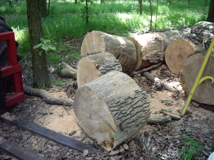

At the end of my firewood making career I came up with this. I thought about adding a cylinder top link but haven't so far. It
would be a great addition.
