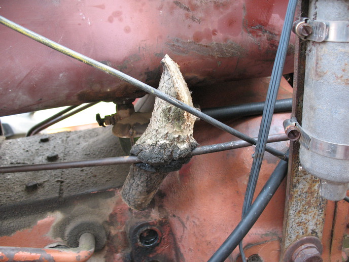

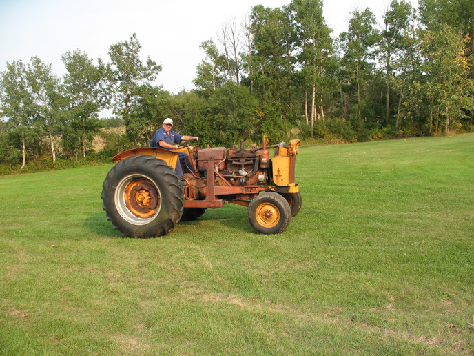

 Re: progress on the m-5 today in reply to carvel minne farmer, 02-28-2018 18:19:54
went out the next week with a gallon of atf, pulled the plugs and poured a quart into each cylinder. looked the tractor over and made a list of items i'd need to get her running?? 4 weeks later went back and got started, pulled the roof and panels off blew out 20 years worth of poplar leafs, twigs, nests, cobwebs and fuzz! changed out the plugs, plug wires, most of the wiring harness,(rotten and dozs of splices) new choke cable, new battery, new fuel line and filter. Harold took the carb into work and rebuilt it, poured in 10 gallons of premium fuel with a little 2 cycle oil in it. Harold climbed up on the seat hit the starter and she was running on the 1st revolution!! third party image
Harold had to cut it out of the trees :lol: third party image
first time she rolled under her own power in 20 years, Harold at the wheel
third party image third party image
I just had to take her for a spin :D third party image
loading up to go to her new home! the trip home was a little slow with all the weight on the back the trailer wanted to fishtail so kept it down below 50 mph.
