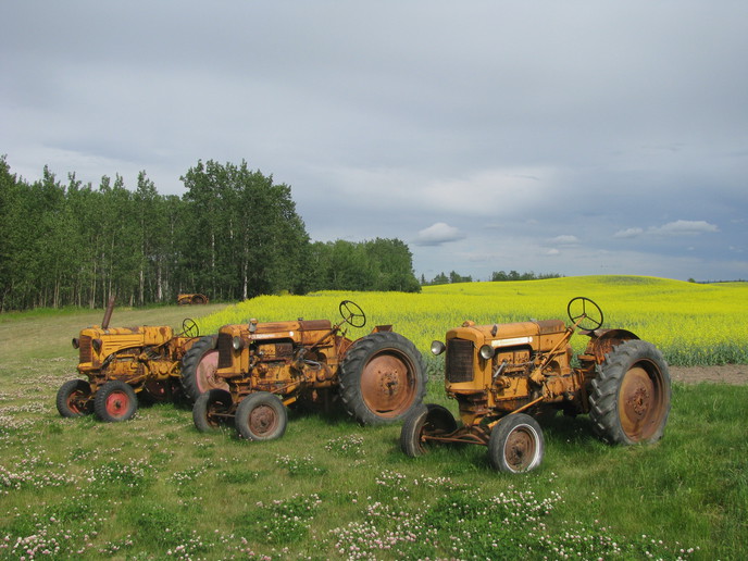

A few years ago I heard of a MMR for sale so went to look and the fellow said yes he would sell it on the condition I took 2 more so picture of the 3 at home .I fixed the later model first ( picture enclosed ) and now working on the 39 modelwhich I will finish this summer

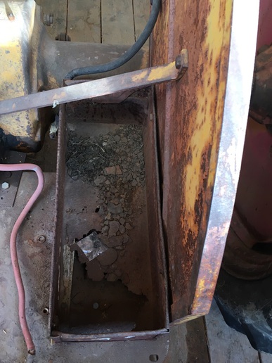

Quoting Removed, click Modern View to seethe measurements of this box is 19 l , 7w and 6.25 high

This is a picture of the battery box on my 39 RTS (sorry I forgot to measure it ). yes a neat line up of tractors there I do not have a Minnie with the front wheel assist but I do have a 97 Massey with it .Our growing season starts with planting end of april 1st part of may and usually goes til the end of oct (usually ) and with being so far north we have a lot of sunlight the 1st part of may we have at least 16 hours and by june 21 we will have over 20 hours of daylight a day.I noticed the old style mufflers in picture would they still be original our are always rusted off.

19l x 4w x 9h battery fit in box?

Minnie u , I see I can't private message. Here is my email, I'm interested in battery box dimensions.

My parts book lists a platform mounted battery box and a 64" battery cable(going by memory on the length)used on the early R's. Yours is more than likely correct. I'll send you a private message.

Parts book show RT853 for battery box until 1940. Box was moved by gas tank and had a common cover used on Z's and U'S RT892 which crosses to 11A330. No cover is shown for 39 year but shows 2 3/8 wingnuts so box would have been basically a holder as platform piece was RT898. Also shows wooden spacer for battery box RT866. Cabbed R had battery box in front corner and had shorter battery cable. My guess is only long old style batteries were available and were shimmmed with wood in box. The 1940 battery box was made to fit square type batteries.

Quoting Removed, click Modern View to seeThere is a box on the right hand floor platform but I can not say that its the proper place ( it looks original )

Minnie u, is there any remains of the battery box on your 39? I'm curious to where it originally was mounted.

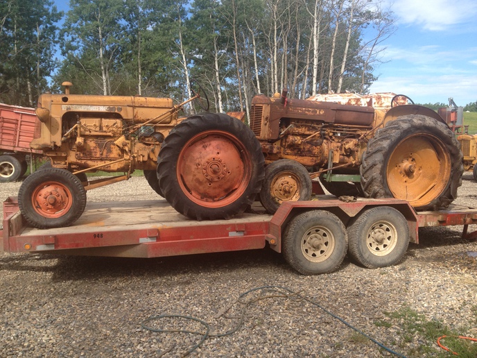

I live in the northwest part of Alberta,as I grew up never did see an R some Zs and quite a few Us. I had posted my 3 RTS I had bought from one person this is #4 and bought later,also on the trailer is my 2nd ZAS I also have a ZTS and a ZAE along with others

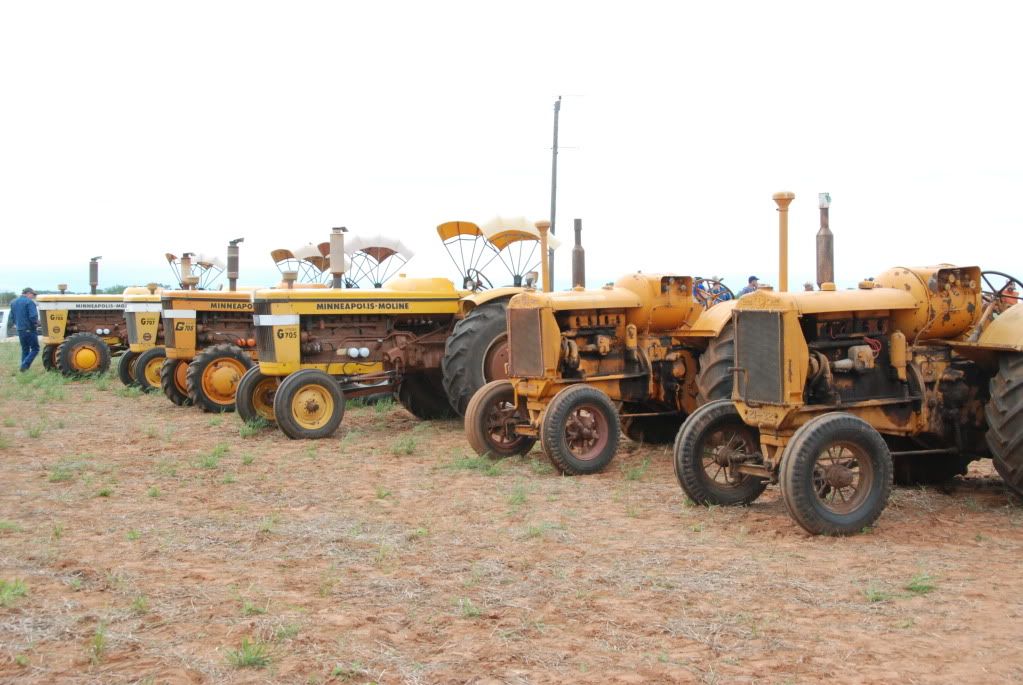

Not to hijack your original thread - but just as a comparison - here is a local auction lineup showing the typical models (except for the G708 ha ha) from a few years ago of a farm family that was diehard MM fans!
They bought several of these tractors new - and still were making a living farming with them when they sold out.

Yes out of the 3 two of them have been chopped

Saves knee caps, but I like to make them original and you can do the brakes while in there. Three in SK same condition but chopped.Some are torched and some nicely cut. Should be a snap ring on outer groove.
Odd configuration as front standard shouldn't back be? Rears were same style on all R models except industrials.

Knew they were in Canada. Are the rear axles chopped off like most. Whole day job to change.
