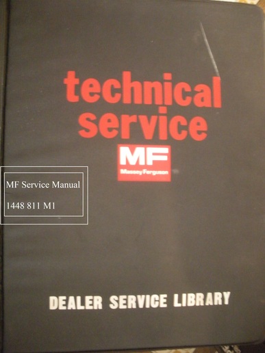

I have a massey ferguson MF-35 service manual for all 35s and a Parts Book for MF35 gas and diesel Form no 651 093 m91. I will look into the manual you posted thanks.

 Re: Massey 35x in reply to Jeremy Rose, 11-20-2023 17:46:05
This manual should be compulsory to own..... ....:)

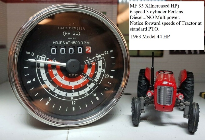

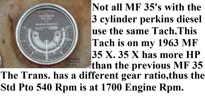

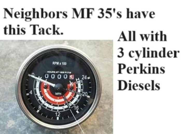

Info on my 1963 MF 35 X..
My parents ordered a 1963 MF 35 X..Left Factory in England,arrived at our farm In Canada.
Differential rear Lock....
Grease nipples on front hubs...
Note Engine Tachometer..
Note Standard BELT SPEED..
The FUEL INJECTORS in my MF 35 X as well as the Fuel Injection Pump is NOT the same calibration as the MF 35's.
An increase in Engine HP with the MF 35 X over the neighbors MF 35 is quite noticeable.
Bob..
