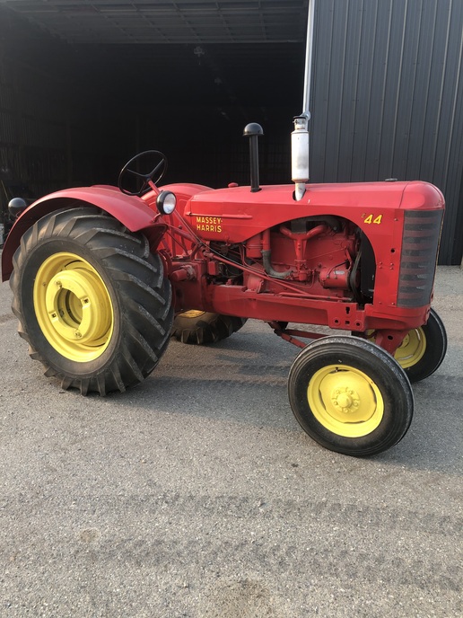

Hello just picked up a massy harris 44 a week ago and am hoping to bring it back to its former glory. First question I have is there a reliable website/location that ships to Canada. Secondly it currently wines at start up with a fully charged battery.(although I didn't load test it) the starter looks like its been removed and at least been painted before reinstalled. and finally when I have had it running it only lasts for 10-15 minutes.
Things I've done.
New spark plugs
New gas
New belt
Cleaned carb
Thanks.

Nice looking machine. The coil was pretty warm and that will be one 9f my next checks. Also took the starter off and triple checked it.

Welcome fellow Massey Harris collector. Steve always has excellent advice follow it. The wine has me curious. Generator or alternator conversion?? Both could still wine even with a full battery. Also how hot is the coil after 15 minutes of running. I had a tractor once that had a wine and it turned out to be the belt. Someone had put an air cooled belt on it. Dont know why it wined but it was the belt. Enjoy that 44 they are great tractors. I have a few. Third Party Image
