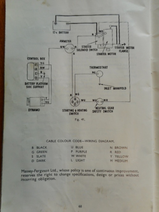

Schematic of my 1963 MF 35 3 cylinder Perkins Diesel,no mutipower.
Bob..

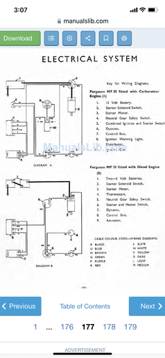

If you have not figured it out yet here is how you switch compares to JDs diagram. The double post 1 terminal on your switch is 1/2 on his diagram, the 3 terminal on your switch is 3 on his diagram, number 2 on your switch is 4 on his diagram. His diagram shows where the neutral switch should connect in. For the battery it was originally a positive ground setup or positive or plus battery terminal connecting to the chassis. The diagram I referenced used two 6 volt batteries in a series to provide 12 volts, see picture lower diagram. However, if by chance it is set up with an alternator instead of the original generator then it most likely has to be connected negative ground. Third Party Image
