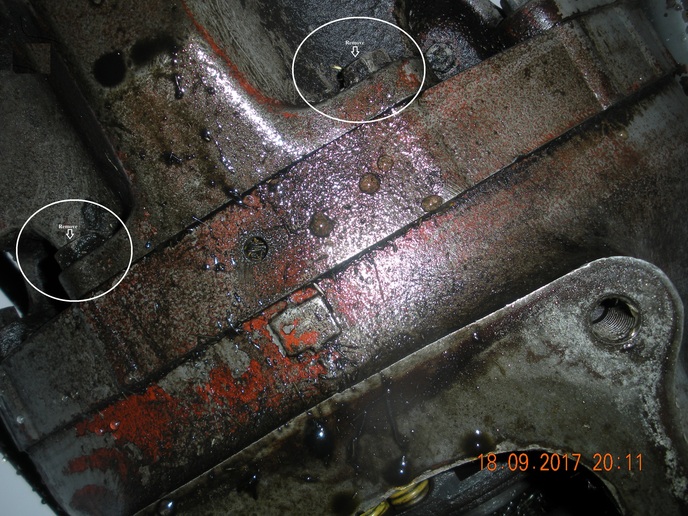

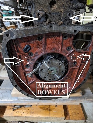

There doesn't seem to be enough room to get the bolts out of the rear main seal carrier. Is the flywheel housing removable? Does the oil pan have to come out?
Third Party Image
[Log in to Reply]  [No Email]

 Re: 135 Clutch parts in reply to jtxn, 11-17-2023 14:48:43
Remove all Cap Screws that attach adapter plate to aft of Engine Block..
Third Party Image
John Deere D
11-17-2023 21:40:51
Report to Moderator
Remove all Cap screws that attach adapter plate to engine block...
Remove the AFT Engine adapter plate that Transmission attaches to..
Top TWO Cap Screws possible HEX HEAD CAP SCREWS?
Bob..

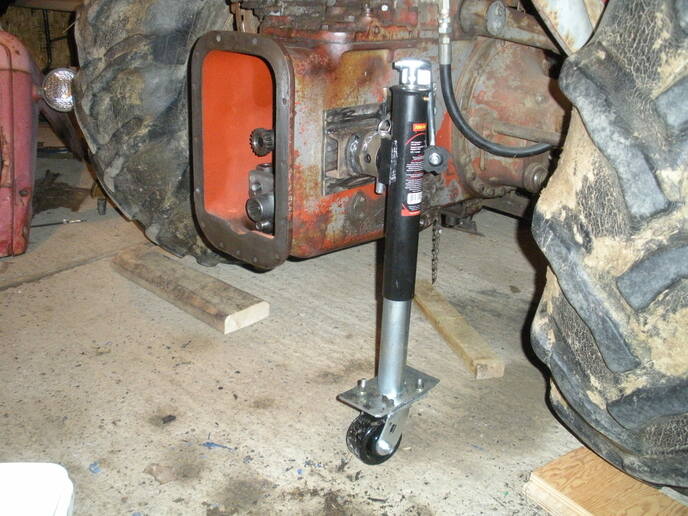

I got the new seals and gaskets in. I'm having a heck of a time getting both shafts lined up from the gearbox into the rear end. Any tips, other than the obvious of making sure it's square?
I don't have a splitting stand or a chain hoist, so I've been using jacks, or the forks on my other tractor. The issue is the dip in the housing, I can't get the lower parts of the two halves flush at the same time as the top. We even got a few bolts in, but then both shafts were bound up.

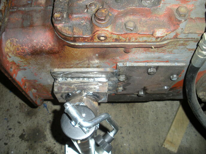

John Deere D
11-08-2023 07:38:27
Report to Moderator
 Re: 135 Clutch parts in reply to jtxn, 11-07-2023 12:43:00

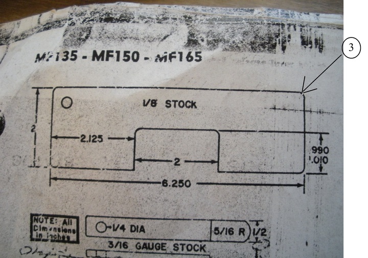

When I split my MF to do the Transs input seals,I attached as per pictures.
As the two halves approached each other I had a helper turn the PTO out put shaft .
Also had the stater removed,and with a pry bar turned the engine over with the Transmission in gear..
Third Party Image
Third Party Image

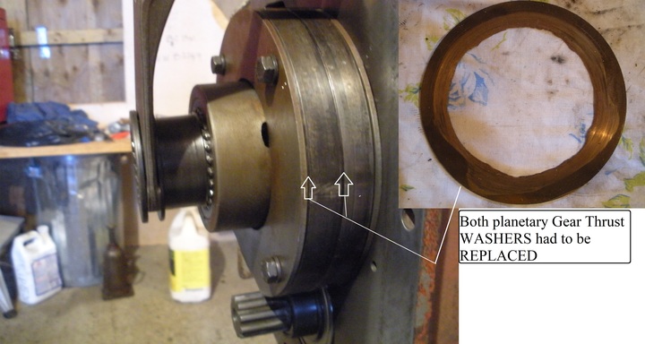

John Deere D
11-03-2023 22:20:28
Report to Moderator

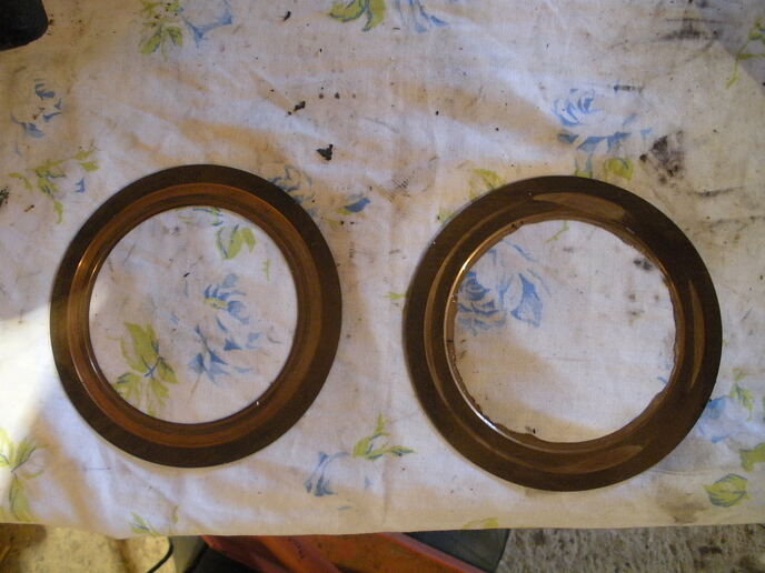

 Re: 135 Clutch parts in reply to jtxn, 10-28-2023 19:41:43

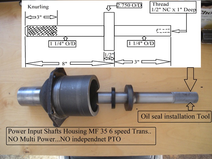

When I replaced the input shaft OIL SEALS...I checked the planetary THRUST washers. They were bad!
Bob..
Third Party Image
Third Party Image
Third Party Image
Third Party Image
Third Party Image

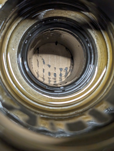

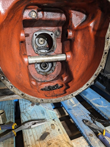

jtxn

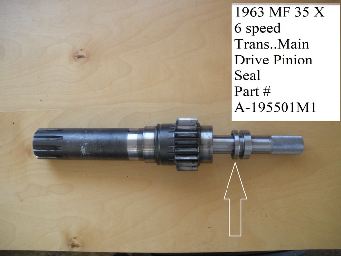

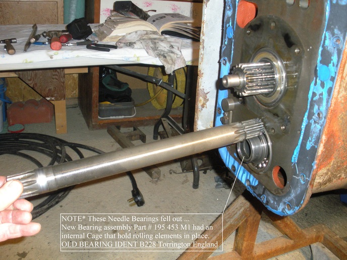

10-28-2023 19:40:24
Report to Moderator
 Re: 135 Clutch parts in reply to jtxn, 10-26-2023 13:53:21
I removed the input shaft tonight. One snap ring did go flying across my shop but other than that it was pretty easy. The shaft did have to slide back a good amount, however I did notice it was threaded in the middle of the shaft, probably for an old MF tool that no longer exists.
A couple of the housing bolts were not even hand tight, and the seals are cracked. I think this is the source of at least one of my leaks, the other being the rear main, still looking for that lip seal conversion kit in the US.
Third Party Image
Third Party Image
Third Party Image
This post was edited by jtxn on 10/28/2023 at 07:41 pm.

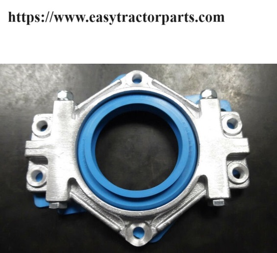

The seal is available through a wholesaler in Ontario. KH Supply carry's the brand Quality Tractor Parts from Ireland. They supply several retailers in Canada. Link
The>Link part number for the modified lip seal is 64965
John Deere D
10-30-2023 06:39:13
Report to Moderator
 Re: 135 Clutch parts in reply to John Deere D, 10-30-2023 06:31:54
I sent you the name of the company that carries the seal,HOWEVER,YT Tractors will not allow the suppliers website address to be posted..??
Link
The part number for the modified lip seal is 64965
Third Party Image

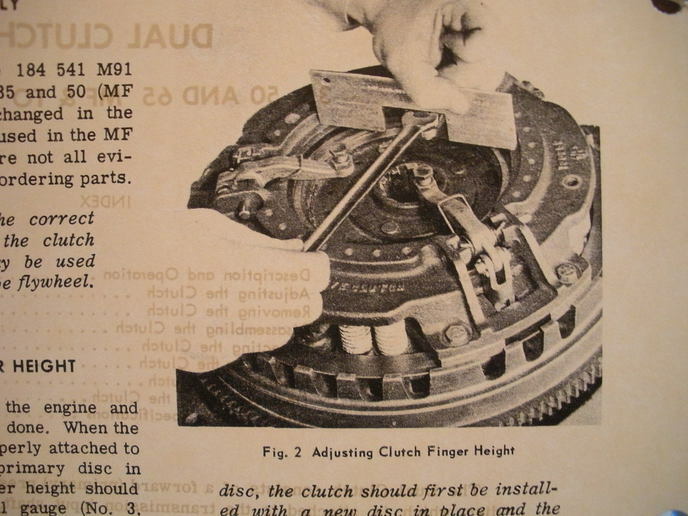

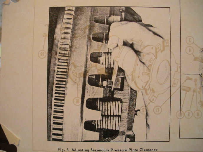

John Deere D
10-26-2023 20:32:32
Report to Moderator

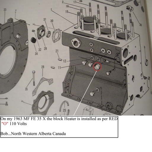

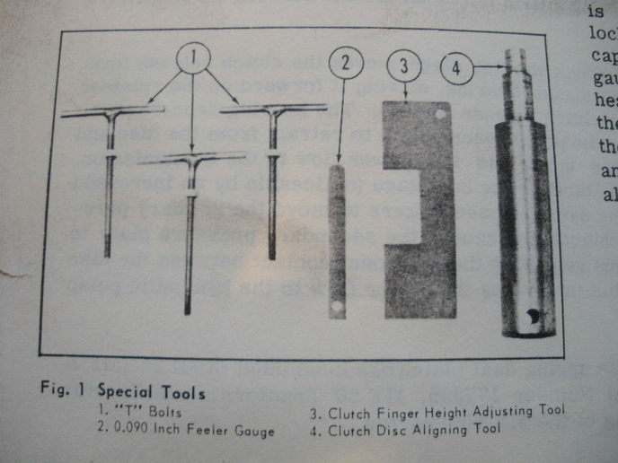

My I ask,have you ever dismantled a MF Transmission as per the one you have posted?
I'm very fortunate to have purchased this Service Manual before I ever started to dismantle a MF 6 speed with no Multi power.
$$$$$$s well invested...
Bob...
Third Party Image
Third Party Image
Third Party Image
Third Party Image
Third Party Image
Third Party Image
