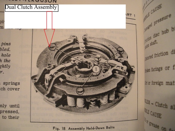

Is your 50 a Dual stage clutch assembly as per picture?

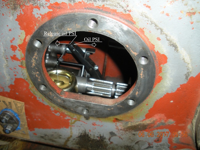

Drain oil from common HYD..TRANSS..DIFF CASE so as oil is below bottom threaded bore / hole...see picture..
Start Tractor...operate hyd lift controls and verify levers and operating as per picture....

Pics are from MF service manual..also of a MF 35 ..

My 150 did that only once. The control spool was stuck. Remove lower bolts on right side cover (sitting on tractor), drain oil level to there, remove cover, check spool movement. Hopefully that's your problem.
