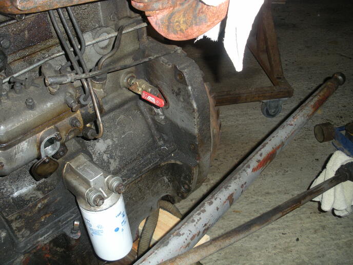

Hi, I'm posting here asking for some help from you guys and gals for my father in law

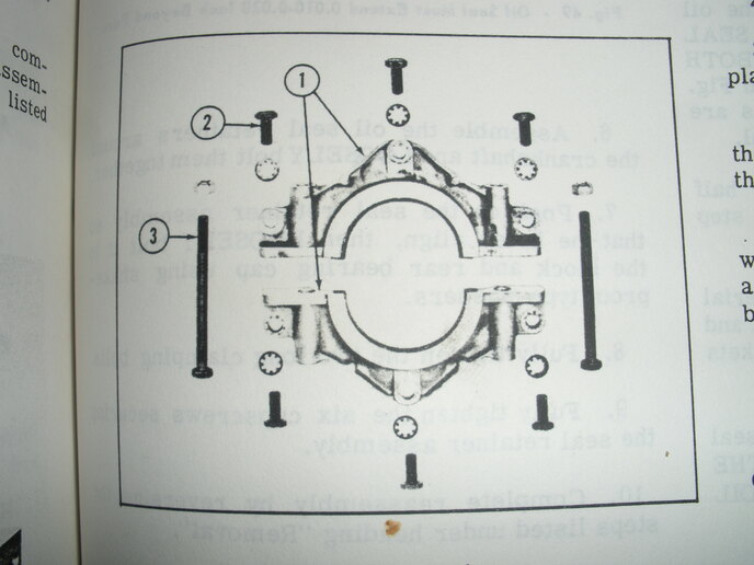

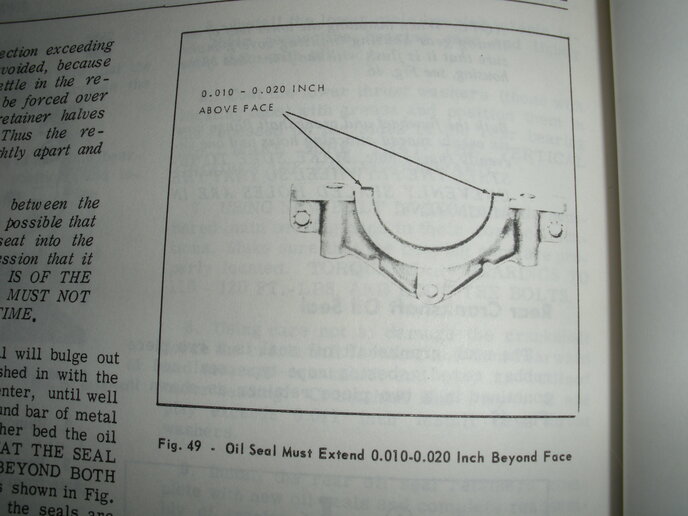

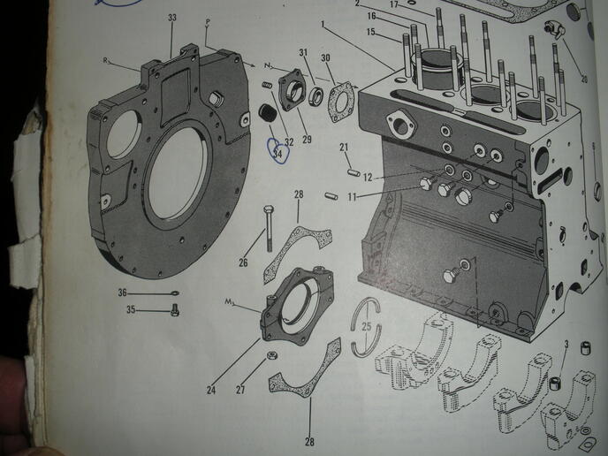

He has split the engine and gearbox and removed the clutch to swap out the crank shaft rope seals but is stuck. There is what appears to be a final 'piece' to remove in front of the seal housing that wont come off of the shaft - any ideas how to tackle this?
The bolts you can see he screwed in
Any assistance greatly appreciated

3 cylinder Perkins diesel Engine.???

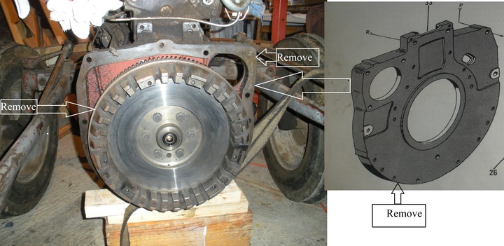

Thanks Bob! I didnt expect such a thorough response. I believe its the same engine as in the section/component drawing but I'm not with the tractor at present to check its a Perkins 3 cyl
Is the part 33 in the component drawing the 'transmission housing adaptor plate' do you think?
regards
Ben
YES... # 33 is 'transmission housing adaptor plate'

(quoted from post at 01:54:09 01/08/21) As per picture..
1963 MF 35 X..
Bob..
<img src="https://www.yesterdaystractors.com/cvphotos/cvphoto70406.jpg">
<img src="https://www.yesterdaystractors.com/cvphotos/cvphoto70407.jpg">
<img src="https://www.yesterdaystractors.com/cvphotos/cvphoto70410.jpg">
Thank you again Bob. I fear your much appreciated and valued efforts are lost. I cannot thank you enough Bob for taking time to try and help
I have been advised that the engine is believed to be a Standard Motor Company 4 cylinder FE35, from '57! :roll:
Does that mean anything to anyone? Help! :lol:
