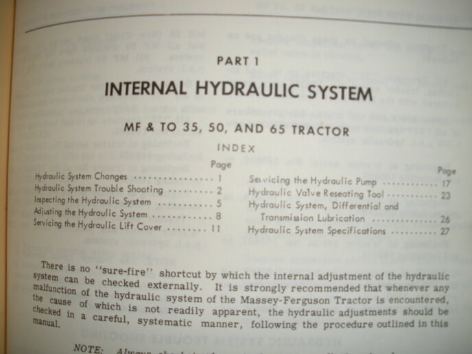

Service manual.......
Way to much info to try without a Manual.......
"YT" used to sell a video on MF 35 lift ....servicing..
Bob..

Okay, this gives some things to check. I ordered a manual so hopefully that will help also.
Thanks everyone
