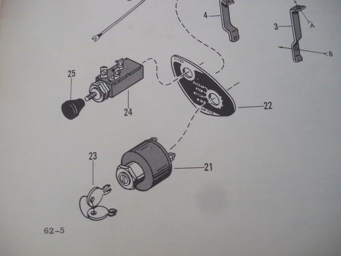

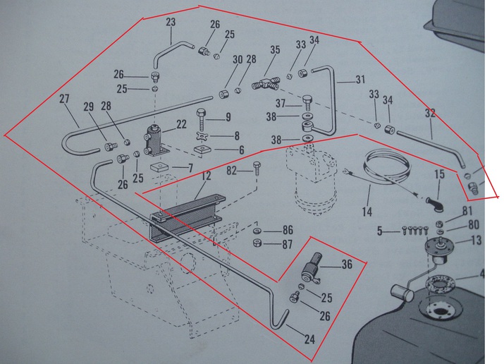

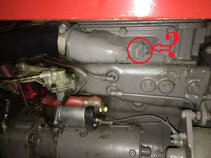

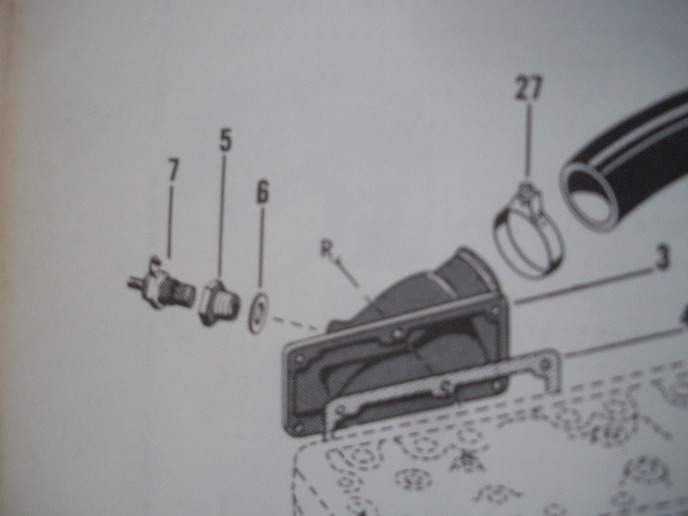

Hi everyone, I m new here. I recently "inherited" a MF 35 tractor. It s a great tractor, but doesn t start if it s cold outside. I ve been doing a little research and decided to post here, hoping someone can help me. I m hoping there is an EASY way to install a glow plug so it will start in cold weather. I noticed that the the keyed ignition can turn counterclockwise but it doesn t do anything. Turning clockwise cranks the engine. Looks like a few people have messed around with the wiring over the years, there s a few that don t go anywhere, and maybe someone removed the original preheat system. I m not a mechanic, and I don t know much at all about old tractors, but I d like to learn more and I m mechanically inclined so if anyone can help out that would be great. I took a few pics. I m really hoping to find an easy way to install a glow plug and switch and get this thing running!

Given your engine already has a coolant heater on it, I would just replace that heater. Drain the coolant, unhook the hoses and mount a new one, replace the hose while your at it if they feel soft. I wouldn't mess with trying to find a cord as I expect they will want 1/3 to 1/2 the price of a new heater for the cord, if you find one. NAPA, TSC, or other parts store, should have one like it in the 500 to 1000 watt range. I would say 1 hour with a 750 watt heater will be all you need, maybe a bit longer at -20. I think warming the engine coolant is a easier on the engine than the thermostart system or glow plugs, definitely better than starting fluid. A couple examples are: Kats 13080 is 850 watts and Kats 13100 is 1000 watts. Both can be gotten for $50. or less in most places. JMHO

You can also replace this "freeze plug" with a heater element and pigtail. That engine is one of the easiest starting engines when below freezing. When feeding and below 25 F I would plug mine in for about 20 minutes and it would start quickly. OR, find a pigtail for the one you have. Might check AGCO parts site and see if one is listed for the 35, if not check the 135. Mine came from the dealer with one when new.

Hi, if you are having problems starting in anything but the coldest weather there are several things to check first. Ensure that the battery and starter performance are good and that all connections are sound. Your compressions may be down perhaps to wear and tear. Make sure that the fuel system is in good order, particularly the injectors. If all is in order you can check to see if it is possible to fit a thermostart (note spelling). Check the key switch for a heat position. A new Off/'ign'/heat/start switch might be needed. Check the upper rear face of the fuel tank for a tapping to connect the pipe whick returns fuel from the reservoir. You will need the reservoir which attaches to one of the rear tank bolts. You will several pipes to connect to the injector drain curcuit. Lastly you will need a thermostart and the fused wiring to it. This should fit directly where the plug is fitted to the inlet manifold. Do not be tempted to make a DIY system as there is a real possibility that fuel could leak into the inlet manifold when left overnight for example. It is possible that if there is fuel on top of one of the pistons that the engine could "hydraulic" when you try to start it. The result......a bent conrod to start.

I posted this on T talk but will post here too. The can with the two hoses coming out of it in front of the injection pump is the coolant heater or more commonly called a tank heater. The two pins coming out of the tank heater are where the pigtail plugs into it. The pigtail will have a female plug with two round holes to plug onto those two pins and a regular flat blade plug on the other end. The pigtail might be missing because it was lost when the tractor was painted or robbed to use on another tank heater or maybe this tank heater does not work anymore. I do not know where you can get a pigtail new. Someone else can fill you out on where to find one.
