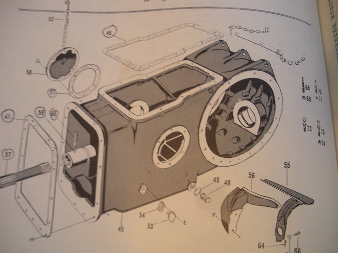

I have hydraulic oil leaking from these 2 areas. Just gaskets / o rings or signal of greater issues? Can the po leak be remedied without removing the lift cover?
Thanks, there are gaskets under the lift cover, I put them there last time I had it off. They are paper thin, like greek pastry crust. OK to use RTV sealant in conjunction with them for a better seal?
To replace the O rings under the 2 bolt cap, do I have to be aware of issues like removing the roller from the pump arms to unbolt the cap and change the o rings?

Nope, the cap lifts straight up. There's the standpipe the cap fits over with O rings at each end, and a square cut O ring in the cap for the lift cover cylinder port. Pipe MIGHT lift up with the cap, or stay in the pump outlet port.
I just tried to repair the same leak on my 135 with a control valve instead of a cover. The stand pipe came out with the control valve. The orings look OK on both ends but now I have zero hydraulics. I've put it together twice. Once with the pipe first then the cover. The second time with the pipe in the cover. Any ideas on what went wrong?
When I installed remote HYD VALVES on my MF FE35 X I had NO oil at remote HYD control valves.........finally I installed the stand pipe...with fuel shut off..Transmission in Neutral and lift control lever up I cranked the engine... there was no %*&&%#$^(* ....I did not have the stand pipe in the discharge port of the oil pump.
Bob..
I'm sure it was in the right place. I have taken off the access panel to the filter and can see if the pipe is correct if I shine a light inside. I'm ordering new orings and a hyd oil filter. Hope that works. Thanks for the picture.
