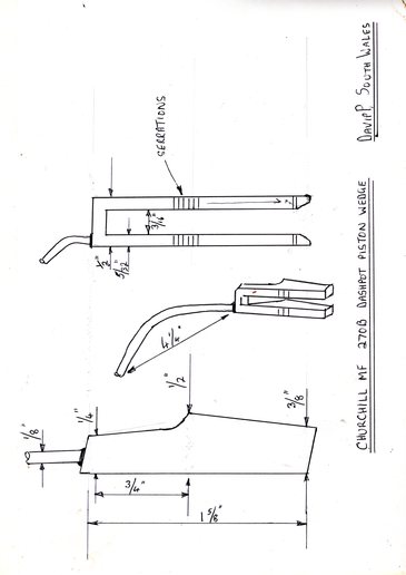

Anyone have a picture or measurements to make this tool? I am in need of this for my 68 175 lift cover adjustment.

[quote="CVPost-DavidP, South Wale"](reply to post at 00:11:27 11/08/19) [/quotethanks for this info. It made all the difference. Lift is back together and working like a new one!]

Hello, attached is a sketch with the dimensions for the MF270B (UK) dashpot wedge. It is essential to hold it securely in place when carrying out the 'Relief Valve Blow-off and Drop Rate' adjustment. This is the only way that you will achieve a consisyent drop rate. If you make a wedge it is essential that it fits inside the pump lever and allows the pump lever to move fully.
Also attached is the sequence for marking the lines on the drop arm.

My manual says to installed this wedge tool. Too hold it in a neutral position. What exactly does that mean? Is it centered or just holds it fully extended? I suppose if I make this tool, it be obvious!
