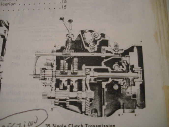

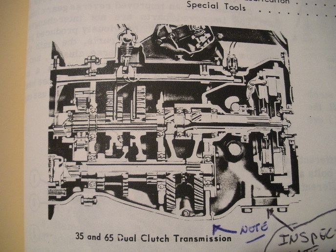

Can anyone confirm what the input shaft for a dual clutch looks like on a mf35 a3-152 please? Pic?

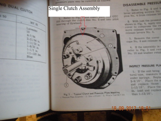

After further internet surfing it appears the input shaft isn't dual clutch, why have I got an dual clutch yet single clutch input shaft, anyone help please?
Got it!

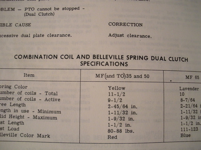

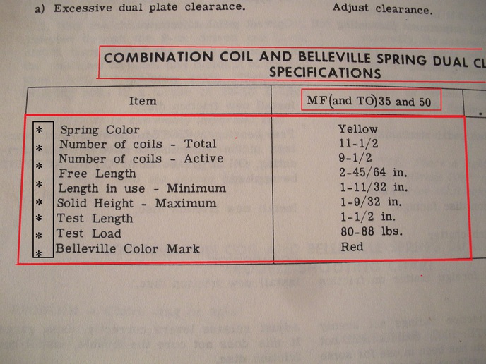

The tractor is fitted with dual clutch with secondary PTO clutch parts removed.

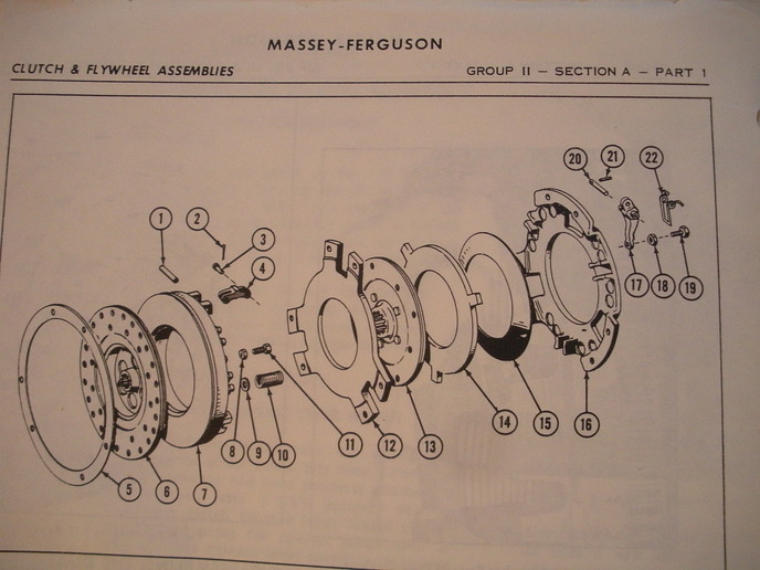

Found text and drawing explaining. Screw 16 is the secondary adjuster missing in pic between yellow springs as removed, as per instruction.

In order for a 2 stage clutch to work, the transmission has to have 2 input shafts, one inside the other. I don't see an outer shaft in the picture. You will need a different tranny if you want live pto.
The internal components between the transmission installed and designed originally from factory with the Dual Clutch Assembly and the internal components used with the Single Clutch are NOT just the input shaft.....

Good day Cloudsurfer.....My MF FE 35 X was built in England in 1963. We ordered the tractor new, specked out for our needs here in North Western Alberta Canada...
I had the SERVICE MANUAL ordered in by a local MF dealer ,May,28,1985 here in Canada...
Manual...1448 811 M1...
Manual...1448 811 M1 shows up on the INTERNET...
I shall follow your adventure with this Tractor with interest, especially, if you decide to turn this transmission into a LIVE PTO TRANSMISSION..
