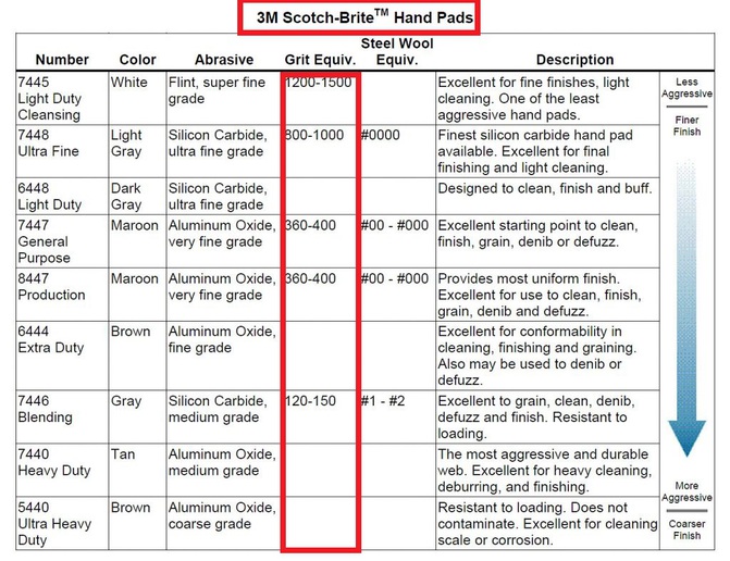

Hi,
thanks a lot Ptfarmer for your suggestion.
I did use a hand wire stainless steel wire very thin wool and got this result, this wire wool is the one used for old wood furniture renovation. It just takes or the dirt with no marks on the metal. Hence I would also use this for polishing the block can it work?
Here some pictures
I then checked the head straightness with a sliding caliper bar and a gauge feeler and the 0,05mm sheet does not slide under it nor length nor wide side so I assume more or less the head is correct.
I also measure the thickness and it turned to be 76,2mm while the engine manual states 75,82mm/76,58mm (2,985/3,015 in)
Question: How can I see where it was already decked/grinded? The head gasket does not report any numbers (i.e. tolerances) but just the wording "MADE IN ENGLAND" and FRONT TOP). Then the manual reports that shims are used under the injectors to adjust their protrusion inside the chamber. As long as I have not found any of them I guess it was not machined.
Liners Fitting: I forgot to ask whether smearing LOCTITE or any similar bonding around the outer surface of the new liners is suggested or not. I am not a real fan of this chemicals. Really..
thanks to you all

ptfarmer
09-13-2019 08:59:19
Report to Moderator
 Re: Perkins AD3 152 diesel inframe rebiult in reply to Jackangel, 09-09-2019 00:53:35
When you press the bushings in they get a little smaller on the inside. On the combustion chambers in the head I would wire wheel all the carbon off, then I would take the all the valves, and lap them to make sure that they still set good in the valve seats so they seal good.
[Log in to Reply]  [No Email]
Jackangel
09-13-2019 07:00:00
Report to Moderator
... then how do i polish the head - valve seats? scotch brite also here?
Jackangel
09-11-2019 07:45:33
Report to Moderator
you mean scotch brite equivalent >1000 grit?
I am purchasing genuine PERKINS head gasket.. should be copper made.. so I think putting some non setting sealant would no be harmful...
what about camshaft pit at lift pump?
ptfarmer
09-11-2019 07:27:10
Report to Moderator
Depending on what the head gasket is made of the instructions should say if you are to use a sealer on it.
ptfarmer
09-11-2019 07:17:51
Report to Moderator
You really can't do anything about the grooves, I would just clean it up a bit with scotch brite. Scotch brite is only going to remove anything that is already loose which is all you need to really do.
Jackangel
09-10-2019 23:42:44
Report to Moderator
Ok. Thanks to all.
I will go for Scothcx brite fine polishing then. Main issue are the gunk / marks on thge cyl#3 parent bore.. you can really feel the grooves by putting your finger on them..
I am not planning to replace the camshaft, or in your option should I go for a new one? The lift pump is correctly operated by this despite the pit caused by years of operation (7000hs)
I do think I ll be going for original PERKINS spares (finished liners), I shown the damaged piston #1 to a local MF / Perkins dealer and in his opinion that damage (cavity on the piston side and footprint on sleeve) has been generated by a faulty injector operations which does not spray correctly so to get an atomised flow
Back to head gasket I am asking if an non setting compote , as Hylomar Universal blue is, is suggested to be smeared over the new head gaskets. Also here your suggestion would be appreciated a lot!

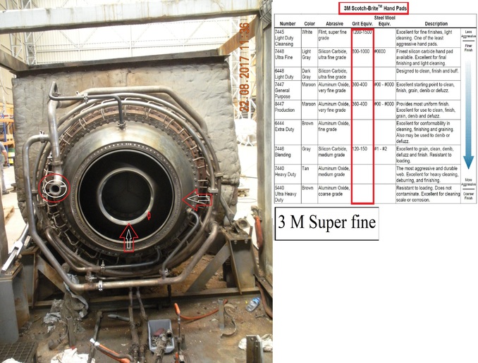

I would NOT sand a thing!
Most of my back ground is the maintenance,operation and test cell time on Aero Gas Turbines.
I never sanded a thing. Used only a 3-M product to clean and never remove any parent material....
General Electric LM 1600
Bob...... Owner operator MF FE 35 X Perkins Diesel...
