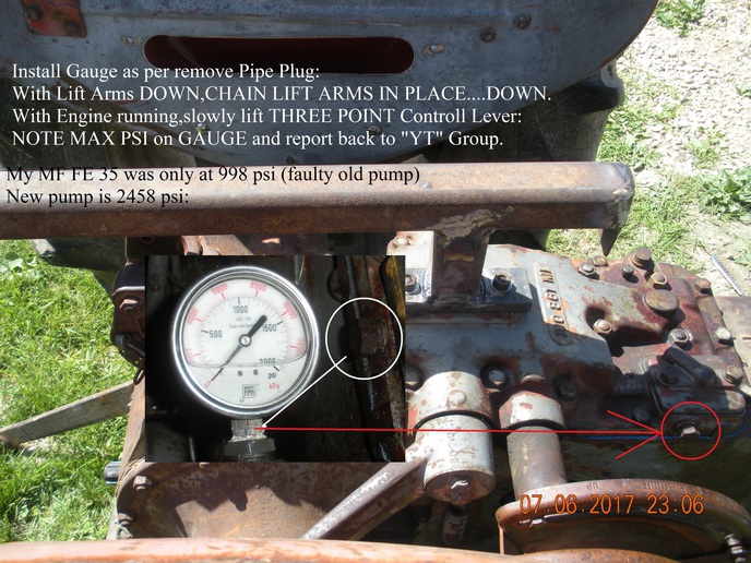

Next project is the hydraulics, it has some type of red fluid in it now which I assume is some type of newer trans/Hydro fluid, I bought 8 gallons of 90w mineral oil for it but after using it some and researching I think I'm going to have to rebuild the pump.
The lift arms fall down within a minute of shutting it down with no load and surge when lifting or even holding a load and have to raise the rpms quite a bit to get it to lift even a few hundred pounds. From what I have researched it is most likely bad rings/seals on one or more of the pump pistons.
So how bad is it to rebuild the pump myself? From the kits I have seen it doesn't look bad. What else should I replace while I'm in there, already planning on the pto seal.

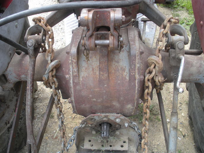

Gauge came in today, installed it and chained the lift arms. 1500 psi was the highest it would go. And the psi pulsed just like the lift arms do.

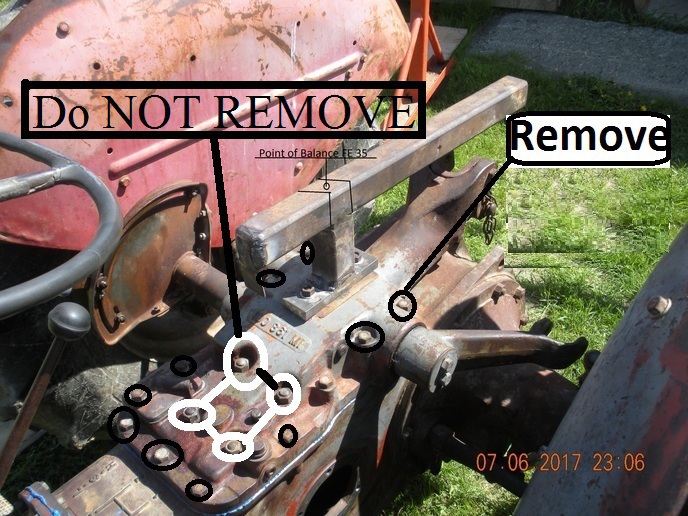

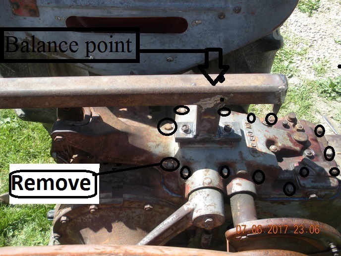

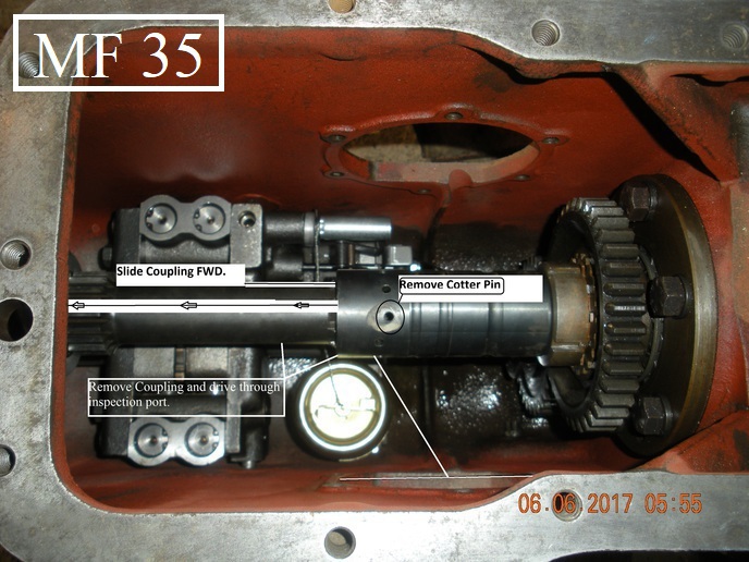

John Deere D
03-10-2019 13:47:41
Report to Moderator
 Re: New member and mf50 in reply to Nathan1989, 03-10-2019 08:04:47
Welcome to "YT"...
I always purchase a SERVICE MANUAL, as well as an OPERATORS MANUAL be fore I ever start any work on a Tractor. I personally do not have enough $$$$$ to afford costly mistakes and oversights. Info that may assist you:
Info from my MF FE 35 X......Pretty much the same HYDRAULIC SYSTEM:
I would NOT disassemble any components until you have ran diagnostic testing,as per pictures:
When I check the HYD. PSI on my MF FE 35 X I secure lift arms down...see picture:
Install HYD. PSI GAUGE as per picture:
Here's a picture of a lift cover that failed..."YT" Archives....probably due to lift travel out of adjustment,and or relief valve faulty:If gauge indicates a HIGHER PSI than specified as per service manual....I would NOT operate HYDRAULIC system until problem rectified:
Bob...Owner MF FE 35 X
[Log in to Reply]  [No Email]
