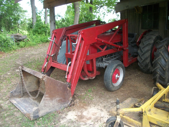

We have a 1958 MF35 and would like to mount a Ford loader model 19-97 to. Does anyone know what front mounting plate is required, or better yet have one available to sell to us. I have the rear mount and assume they are the same whether you mount to Ford or Ferguson since the rear axles are so similar, but if there is a different mount for the rear id like to know that info too. Thanks, Keith
My 35 has the 90 something ford loader on it with front mounts to the 4 bolts under the bolster.
2tractors, I am mounting a Ford 19-97 onto a Massey Ferguson 135. I moved the controls and the supply line from the front pump to the outside of the frame. I extended the rear arms six inches to go under the axel. I have not decided how to fabricate the front bracket yet. Could you post a couple more pictures of your front and rear mounting brackets as examples please.

<img src="https://www.yesterdaystractors.com/cvphotos/cvphoto15897.jpg">
<img src="https://www.yesterdaystractors.com/cvphotos/cvphoto15898.jpg">

Ptfarmer, are you trying to show me that these brackets are available for sale still? If so, I just realized this. Where are these parts pages copied from? I was trying to find it on the web so I can inquire about them. Thanks, Keith
(quoted from post at 16:20:41 03/12/19)
(quoted from post at 19:09:17 03/11/19)
Some of them may still be available, you can search the part numbers on tractorhouse, or a Case/New Holland dealer like Messicks. Should you decide to fabricate the brackets you will have some idea of what they look like.
