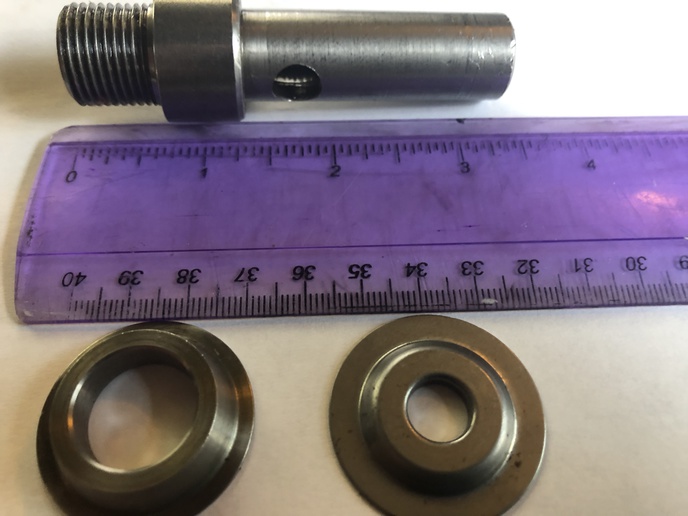

I pulled the stud from the pump. Hard parts individually less the spring and assembled with with the 1.6" high filter. Filter is about 1/2" short or shaft is 1/2" long
Does this help make clear the issue? any ideas?

So my calcs ....if I am correct
Working area of the sleeve is .331
Center of the sleeve is .1655
Shaft movement up .0625
Shaft movement down .0625
Perfect placement would have the the pressure lip of the seal center with the sleeve when the shaft is neither raised up or down.
It would be nice if the sleeves were an inch wide. I feel a headache coming.
Don

Don, I just went to install the speedi sleeve on my shaft and it just fell right down to the bottom. I had to tap the other one on with a plastic mallet. It's no good loose like this.
If you haven't installed your sleeve yet, could you please measure it? My sleeve measures .875" My shaft measures .873".
Thanks Cary
Hi Cary,
I am sorry I did not write down the measurements and mine is installed with JB Weld. My outside sleeve measurement .90 to .91
Don
From the SKF product brochure.... Which is why I used JB Weld

But I'm wondering if you could get an .865" sleeve on an .873 shaft without screwing it up?
The shaft where the seal rides is larger than the rest of the shaft. There is a shoulder just above the seal where the shaft narrows. Could you tell me where you put your seal in relation to that shoulder? You see the shoulder I'm talking about in this picture.
My pump reservoir is about 3" high and 5" wide. It would help me to confirm that the pressure port is on the bottom and the return on the side.
I measured the lip of the seal to be at the straight / flare joint on the cover assembly. Again, I did not use the seal called for. I went with the narrower seal because the sleeve is so narrow, it is higher pressure at 50psi and has a double lip.
I pushed my sleeve down as far as i would go.
It looks like you have the sleeve in the same place my first one was and remember mine started leaking again.
