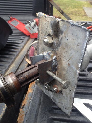

Me too. I think my seal was original from 1964, it didn't leak but I had to remove the hydraulic pump anyway and figured "while I'm in there" and I've got it all removed.
Here's the adapter I made up quick. It's ugly, all I had on hand was a piece of angle iron so I split it down the angle with my plasma cutter, pounded it flat, re-welded it into a plate and quickly cut holes in it. One day, maybe I'll make it pretty. It got the job done in about 5 seconds when I'd been prying and pulling on the PTO shaft for about 30 minutes and it didn't move.
Pro Tip- use a slide hammer! :)

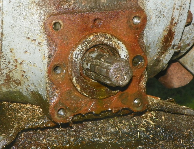

After removing everything around the PTO, here's what I'm left with:
third party image
The flange around the shaft turns freely, but there it has no front/back play in it at all. The flats on the side prevent it from turning when the bracket is bolted on.
Where do I go from here?

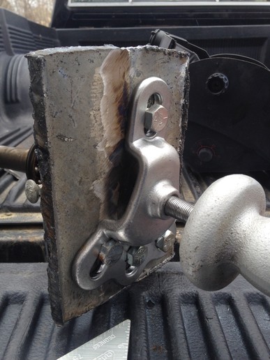

I have a 150, should be the same PTO shaft. In the pictures, it shows a small tapered punch in the shaft hole to pull assy out. I had to adapt a slide hammer to remove mine.
Seal 186 0325
O-ring 195 522
Credit pictures to Big Deans
