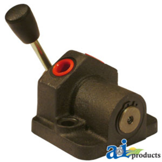

I'm wanting to replace the cover cap on my MF135 with a diverter valve so I can choose between my 3 pt and an external auxillary cylinder.
I'm looking at one like this: Model VDF1104
third party image

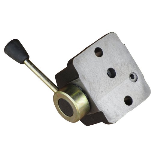

There's something similar on this forum however the mounting holes are offset at a diagonal... which means the valve would be sitting on the tractor kinda cattywampus... the plus side is the inclusion of a return port on this one which would make my install more simple (I have a return line going into the cover plate which is currently installed on my tractor)
third party image
Going back to the VDF1104... anyone using one of these?
The description I've found on the internet says there's a return port on it but the photos included with the description don't show a return hole on the bottom of the valve...

Just realized the top picture in my first post is from across-the-pond and features BSP threaded work ports... won't work with my NPT connections... :?

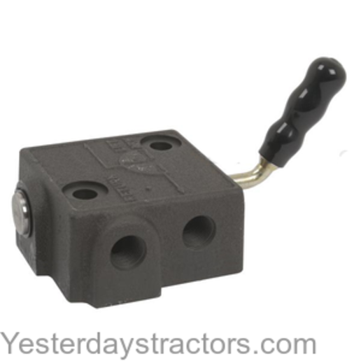

Anyone using a TS300 valve like this:
third party image
I'm curious as to the two stacked ports at the rear... are they both pressure or is one a return line? (the front port is for a one-way cylinder? which I can block off)

I have the 2nd from top photo diverter on my 165. It works good. I replaced the other one since it was always getting hit by my foot when getting on or off tractor and then pop out of hydraulics. I would not want the 1st photo one, looks like easy to move handle accidentally with foot also, or worse trip yourself.
