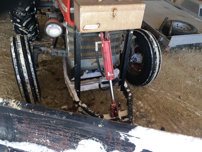

This past autumn I purchased my first ever tractor, a MF 135 Deluxe. It came with a snow plow mounted on the front.
My issue is with the 3 point lift. The arms drop "immediately" upon shut down of the engine (about 3-5 seconds)... When the engine is running I can push down on the arms and cause them to lower... they come right back up when I stop pushing down.
The front plow is hydraulically raised via a cylinder connected to the hydraulic lift cover (#3 in the photo has been replaced by the previous owner and has two lines running to a control valve for the plow). The front hydraulic works just dandy... (I can literally raise the front of the tractor with down pressure on the plow) ...which leads me to believe the hydraulic pump is working as it should.

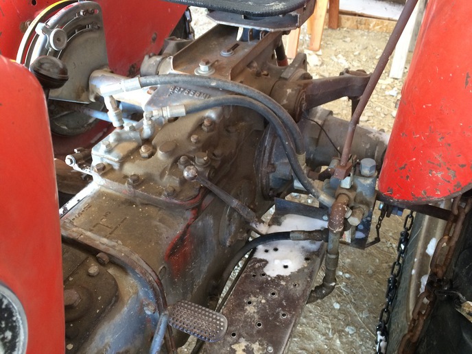

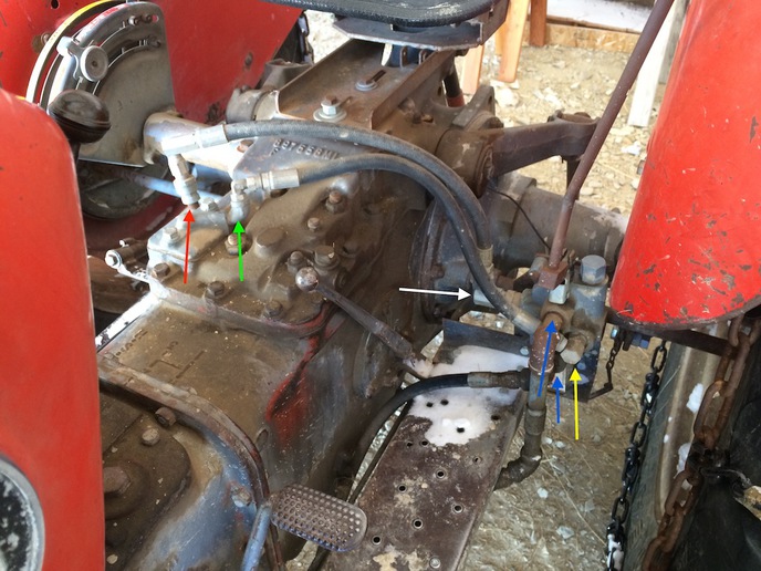

Here's a photo or three showing the current set-up...
The top two pics are the same except for the colored arrows added for clarity...
My guess is the line from the red arrow to the white is the supply line.. the yellow to green is return and the blue are work ports... the top blue port runs to the top of the front cylinder (lower blue to lower front)...
So... what's next?

My OEM transfer plate has been replaced with something... a "diverter plate" for lack of a better term? It was installed to divert the flow of oil to an outside accessory rather than keeping the oil flowing inside the confines of the tractor rear end.
If I install a shut off valve in the supply line where will the oil flow from the pump go? It could be there's no connection between the two ports of the diverter plate ... any oil flowing through the diverter [b:04b5785ece][i:04b5785ece]must[/i:04b5785ece][/b:04b5785ece] exit the tractor in this case...
I found a 3 way valve on Amazon that could solve this issue... if it is an issue... the 3 way valve hooked between the two ports of the diverter with the third leg heading over to the spool valve... I'd need to install a check valve in the return line from the spool valve...
Dang... I'm probably making this way more complicated than it needs to be...
You have it backwards, the GREEN arrow is the supply line TO the valve, THAT'S the line where the on-off valve should be. Red line is the return from the valve. With a shutoff valve you can choose to shut off the blade lift cylinder valve for three point use. With the valve on, place the position in constant pumping, block the lift arms up so they won't settle. When the arms DO settle they must lift full up BEFORE the blade will lift, killing time..
