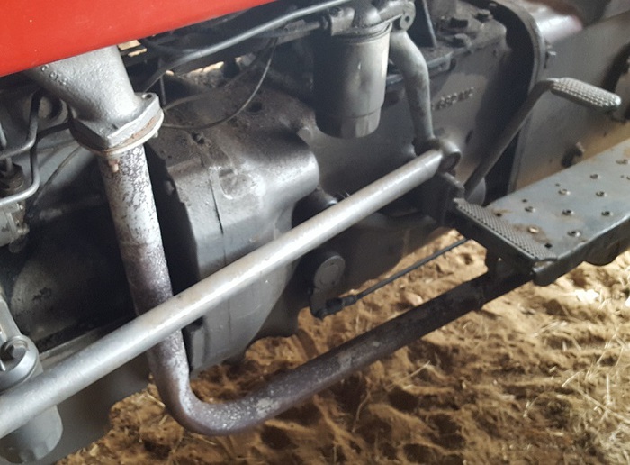

My MF135 exhaust, it will be going vertical very soon.
I added a extra hanger in front of the muffler, I also made it come out by the wheel so you don't have the exhaust blowing on you when hooking something up.
I like the set up. Is that the original exhaust manifold? I looked at my uncle's UK built 135 with straight front axle the other day and his horizontal exhaust runs down very near the vertical bolt flange unlike yours and I think it's because his exhaust manifold is different and sticks out less.
(quoted from post at 22:05:03 02/14/18) I like the set up. Is that the original exhaust manifold? I looked at my uncle's UK built 135 with straight front axle the other day and his horizontal exhaust runs down very near the vertical bolt flange unlike yours and I think it's because his exhaust manifold is different and sticks out less.
As far as I know its the original exhaust manifold, and the exhaust pipe is really close to the oil pan before it starts to bend back.
A MF240 (made in England).
