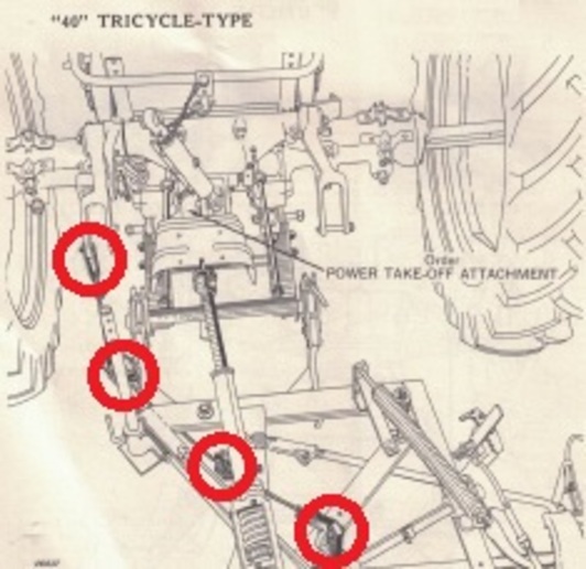

"[b:654c4848f0][i:654c4848f0]how did you hook up the cylinder to lift the bar[/i:654c4848f0][/b:654c4848f0]"
Reviewed a couple No. 5 mower manuals, but there was no information on the Model H cable hookup.
However, there was information on the Model 40T.
Take a look at the illustration below.
There were no part numbers or descriptions for the cable, pulleys, cable clamps, etc.
These parts should be available at any reputable hardware store.

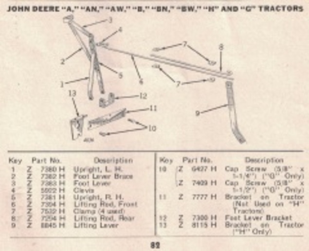

"[b:654c4848f0][i:654c4848f0]foot pedal lift assembly with the adjustable rod[/i:654c4848f0][/b:654c4848f0]"
Take a look at the illustration and descriptions below.
Note the foot control lever is designed for both the Model B and Model H.

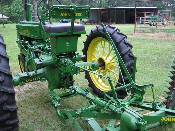

Take a look at the photo below.

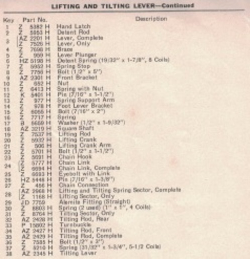

"[b:654c4848f0][i:654c4848f0]also need the hand lift lever[/i:654c4848f0][/b:654c4848f0]"
The lever is standard equipment on the No. 5 mowers.
Hope this helps.
