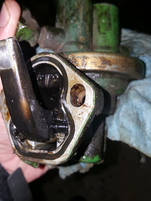

Took the lift pump off tonight. Hard
telling but the inside bottom of the pump
looks a little washed?

The base of the injection pump was pretty
wet so wondering if it's the umbrella seal
that's compromised by the flex ring.
Set the flywheel mark on tdc then it wont matter if the pump is off just a bit just line it up when you put it back on . Lift pump looks shiny what does it smell like ?
(quoted from post at 23:49:57 02/21/21) Set the flywheel mark on tdc then it wont matter if the pump is off just a bit just line it up when you put it back on . Lift pump looks shiny what does it smell like ?
Thanks. Hard to say what the smell is like. Defintetly doesn't have strictly an oil smell. A bit exhaust/sooty smell as well as im sure there's some blowby fumes that make their way into the crankcase.
Well you could try a new lift pump they are only about 60
dollars if it doesnt fix if youll have a spare but that still
doesnt Address your throttle issues

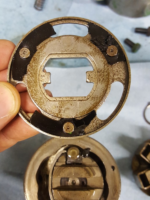

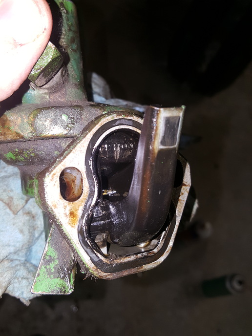

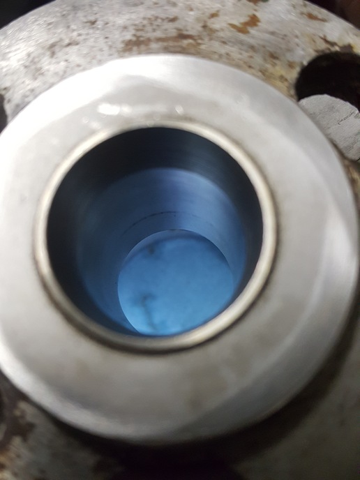

Pulled the injection pump off and opened up
the rear cover. Not surprisingly I found
little bits inside that has to be from the
gov ring.
Stay tuned.
Looks like there's some NASTY deposits and/or "slime" from fuel that went bad on the interior of the I.P.

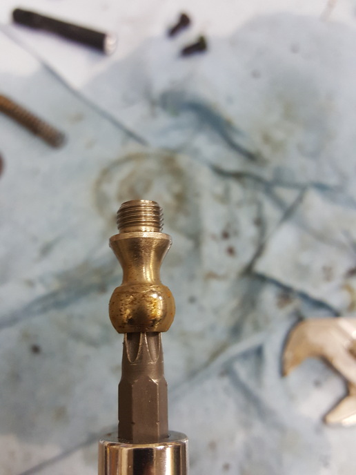

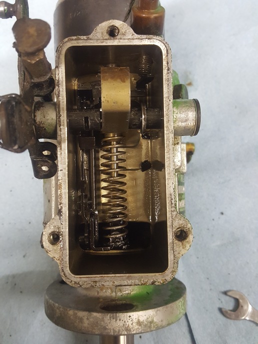

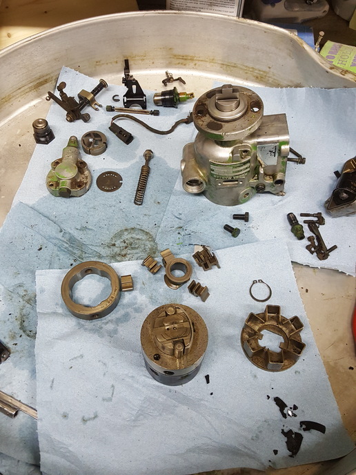

Well I got it all apart tonight and sure
enough the flex ring was to blame. That
timing advance screw was making me very
nervous. I gave it a few big whacks with a
punch before I tried anything, also thru
some heat at it. I had to grind down the
sides of a T45 bit just a hair and used my
impact screwdriver first. That didn't touch
it. Hit it both loosen and tighten
directions to try and jar it lose but ended
up putting my impact gun on it set to the
lowest setting. Spun right out. What a
relief!

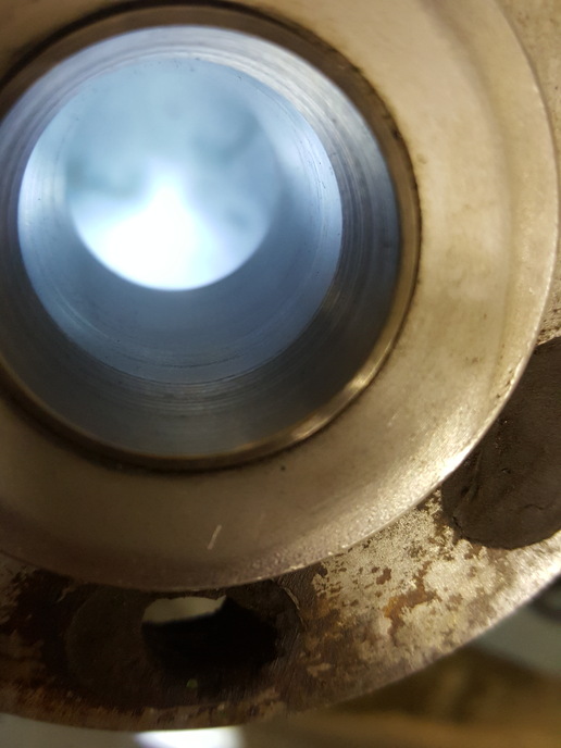

The pilot tube was in better shape then I
thought it would be. I have one on order
since I assumed it would be scored but
there's only one tiny line in it that I
think I can smooth out with some emery
cloth but figured I'd get your guys opinion
on it.
Here's some more pics. Overall successful
night.
Got the pump put back together last night
and finished reinstalling it this evening
with a fresh oil change. Took a bit to
prime but it came to life and purrs like a
kitten. Sad thing is its never sounded
this good or ran this clean in the 5 years
I've owned it. I thought that's just how it
was not knowing much about these older
diesel's. Poor thing probably needed a tune
up the whole time.
The pump went together very smooth and
relatively no issues other than the weight
basket getting upset the first time trying
to get the throttle linkage in. Couldn't
get the linkage to slide in below the
little spacer that sits inside the weight
basket. Had to pull it out and redo it.
Went together fine after that.
