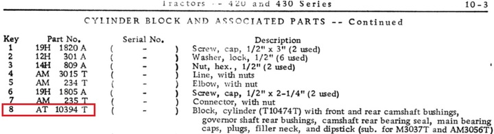

James Howell
01-14-2021 14:43:00
Report to Moderator
 Re: 430 engine block number in reply to putput man, 01-14-2021 07:39:01
"Has anyone ever seen a block number start with a letter?"
Yes.
Take a look at the CYLINDER BLOCK AND ASSOCIATED PARTS table below.
Note the Block (Key 8) Part No. AT 10394 T.
This part number is used for all tractors both the 420 and 430.
[Log in to Reply]  [No Email]
