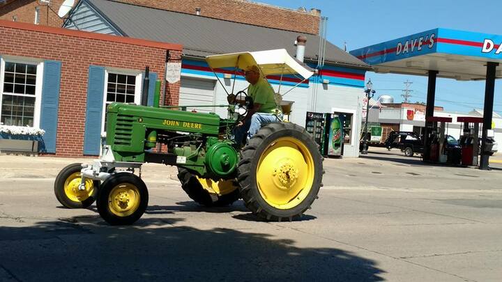

Hello. I have a 44 model B that I restored years ago. I want to convert a wide front. I have an opportunity to purchase a wide front, complete with pedestal for a 47 model G. I know there is quite a size difference between the two models. Would a G wide front and pedestal fit a 44 B? Thank you for all the feedback and assistance.
Oh ya, it'll fit, kind a like this:
Please, take no admonishment, just could not resist.

Any pictures of the tractor after install? Trying to keep it John Deere so it would be a no modification required install.

(quoted from post at 02:05:11 12/07/20) The axle should be fine, but a B will need
a B pedestal not a G pedestal.

(reply to post at 04:50:55 12/08/20)
Thanks for the pic. Good looking tractor. I gave up the search and just bought a true BW to restore. Not the way I wanted to go, but it was too good a deal to pass up.
Sounds like its a moot issue now, but after rereading your original post the 1947 G axle wouldn't have worked on a 1944 B (assuming this was a OEM Deere axle and not aftermarket). The 1947 G axle would work on a late B with a pressed frame, but not your 1944. Until I reread the parts books I forgot that there are different split pedestals for early and late tractors and the early one you would have needed I don't think would have the correct holes for the axle on the bottom, and the late pedestal that would have the correct axle holes won't bolt up right to an early tractor (at least you can't mix early and late ones on an A, learned that one the hard way :) ).
