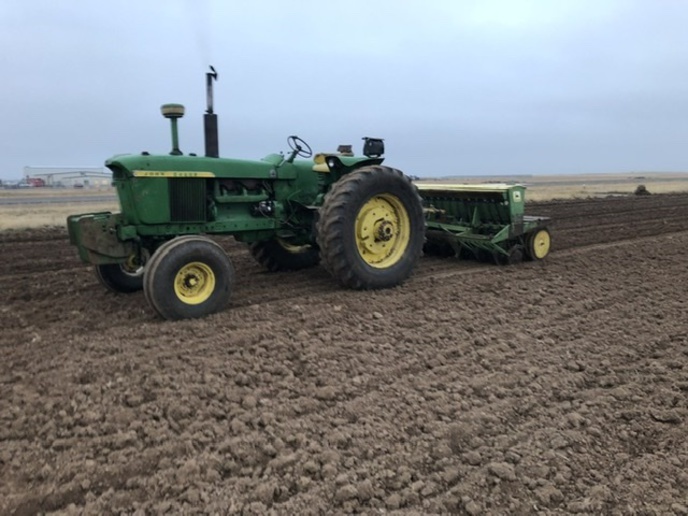

Syncro-range trans has 4 ranges with 2 fwd gears in each range with 2 lowest speed ranges offering reverse. These trans can be shifted on the move within each range by simply depressing the clutch BUT one needs to stop tractor movement to change ranges.
Powershift trans is a semi-automatic with 8 fwd/4 rev gears that can be shifted on the move simply by moving gearshift lever. This type trans has a foot pedal referred to as an "inching pedal" that controls a hyd valve to aid in attaching equipment to tractor.
Both are reliable trans but as with all equipment expensive to repair. Powershift can be jerky changing some speeds.
Shown in photo below is SR shift pattern on LH side & PS shift pattern on RH side.
