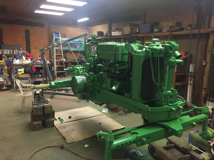

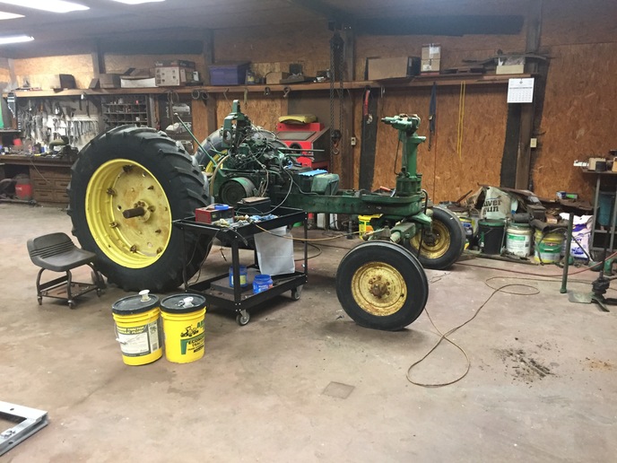

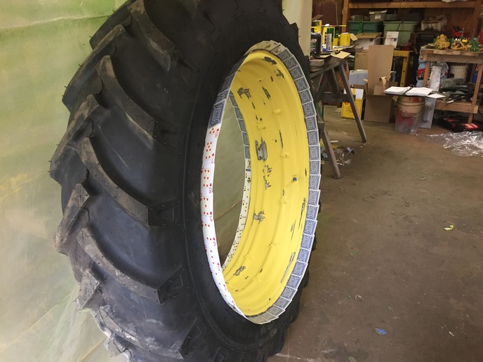

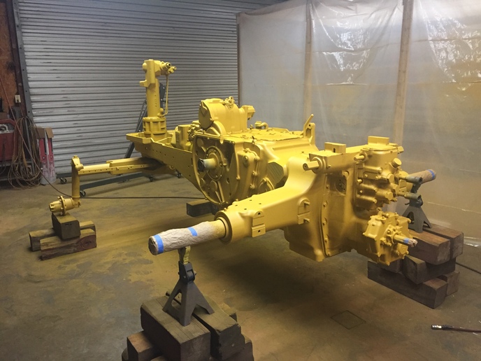

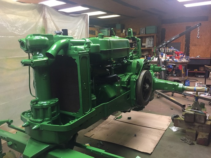

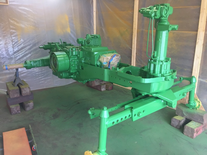

Here are some pictures during the work.

Never saw that card trick before, something tells me this was not your first rodeo.

It has all the decals on it now, I just did not have them on when I took the photo. I am not sure about how many hours, but It has been in my shop for about 4 months and I worked on it 5 to 6 days every weak. Some long days and some short days. I would guess I averaged 30 to 35 hours a weak... Dang I am retired!! I am going to have to go back to work somewhere so I can get some rest.

I rebuilt the ignition system for the pony motor, also installed a new clutch in the pony motor 2 times (the first one failed after about 6 starts. The pads on the clutch came lose on both sides. glue???) I installed new seals in the pony motor transmission as well as the brake. Turned the flywheel starter ring 90deg.(Bad places in the teeth)and replaced the fiber thrust washers and reset the end play on the crank. Replaced the cam gear(broken tooth). Replaced bearing in the governor drive gear. Rebuilt the water pump. Installed a new rad.core as well as several gaskets and other odds and ends. Its a lot of work for an old retired man working by himself. A lot of time was spent on cleaning parts and getting them ready to paint.
