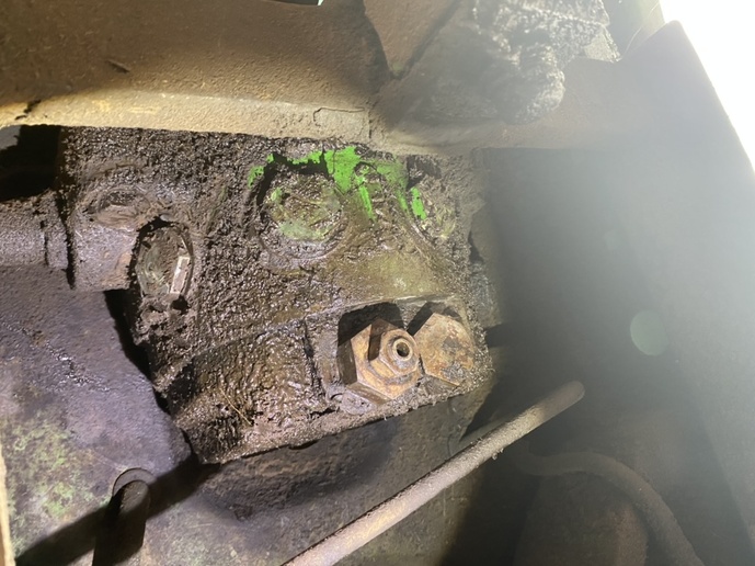

See the following URL for questions/ discussion on a JD 3010 Propane tractor that lost hydraulics to the front loader and 3 point. My main question is the manual shows a shut off screw (de-stroke) on the bottom of the pump. There is a screw there but have been told it may be the pressure adjustment screw for the pump. Ive also read that there are de-stroke screws with a T handle and some with Allen head Iíve attached pics... Could this be the de-stroke screw?
Rick3
07-18-2020 12:31:31
Report to Moderator
 Re: John Deere 3010 Hydraulic De-stroke in reply to Rick3, 06-22-2020 19:00:46
WTW... I ordered a destroke screw and went to put it in today but it is too large... the plug right above the stroke control valve is 11/16 bolt head and the threads are about 1/2. Do you know which destroke screw I should order?

WTW
06-23-2020 07:21:04
Report to Moderator
Rick, The top Photo is the pump pressure adjusting screw as Tom stated. The bottom picture is the destroking screw. Where thing are confusing is the original pump in the 3010 the destrokeing screw is on the bottom and adjuster was on top / opposite of each other in same bore. Later replacement pumps the internal stroke control valve and these two features were revered from top to bottom, like 20 series and later pumps are. If your tractor does not have the destroke screw you simply remove plug on opposite side of adjusting screw and swap it with destroking screw that is readily available. As previously stated there is two different ones used depending on pump cover. DW
[Log in to Reply]  [No Email]
Rick3
06-23-2020 08:09:18
Report to Moderator
 Re: John Deere 3010 Hydraulic De-stroke in reply to WTW, 06-23-2020 07:21:04
Thank you for the clarification! It sounds like the pump on this tractor is a replacement pump... I will get a destroke screw and install in the top location.

tomstractorsandtoys
06-22-2020 19:07:44
Report to Moderator
No the screw you have is to adjust hyd pump pressure. Tom
