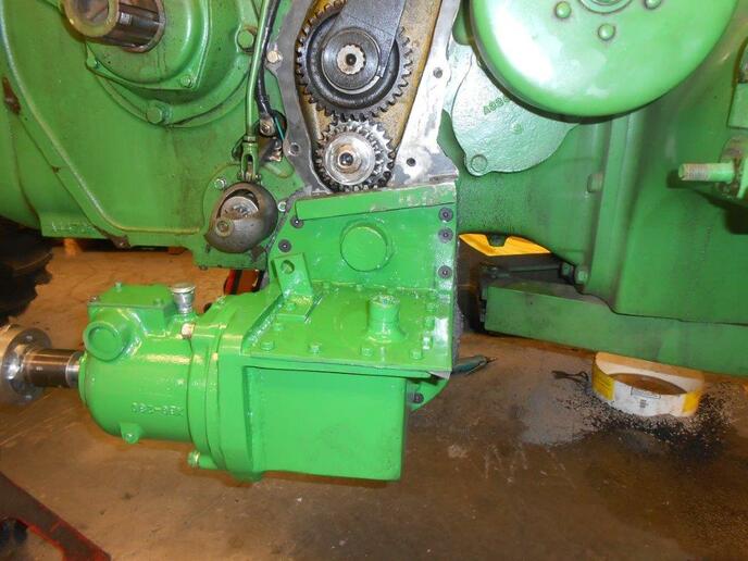

There is an unusual 4020 for sale. I have seen them with Elwood on PS, but rarely on SR tractors. There was a 4010 like it a while back, but without as many pictures. It would have been nice to get some more pictures of the setup.

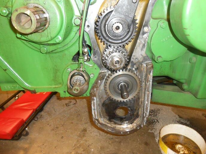

There's been pictures on this forum before of 4020's with ELWOOD FWA. I thought the driveshaft ran down the right side of the tractor. Years ago, late 1970's/early 1980's I talked to THE engineer at Elwood about their FWA system for the Deere tractors. He said the power was tapped from the top of the transmission via duplex roller chain, over to the side, then down. They had their hands full making axles for FARMALL and dealers and farmers that ordered axles to install themselves.

Interesting. I have am elwood/emco MFWD set up for 4840. It has a transfer case that bolts on to of tranny and drops down. Never used it just setting on the shelf if anyone has a use for it,

I would like to see how they got the source for the transfer case,,that was the issue I had when I made my 60 4X4.

There are about 30 pictures and 3 videos on auctiontime. Looks to me like the transfer case is hooked to the front PTO area?????

That is the tricky part,,getting the power out of the transmission case, then syncing it to the wheel speed

I seen a 4520 with a mfwd and it had a transfer case looking unit on the side front of the transmission
