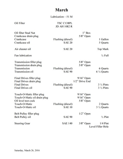

Agree with [b:654c4848f0]Mike M[/b:654c4848f0] that "[i:654c4848f0]The original owners manual should have all the info on maintenance[/i:654c4848f0]".
Take a look at the lubrication list below for "Sparky" our 51M.
Hope this helps.

For making the picture bigger, in the past, I have uploaded pictures to google drive and posted a sharable link so everyone can view it at full resolution but not sure how that works on the forum.
