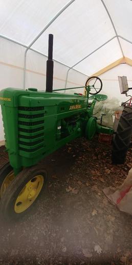

How does John Deere's buff primer compare to a 2 part epoxy primer? If I use the buff primer I would only use it on the case, engine, rear end, wheels, and some other non-visible parts. On the frame, hood, grille, and pedestal I'm going to bodywork and fill primer so I'll need the two-part epoxy so I won't have any lifting issues. Is there any reason to use the buff over the epoxy? Thanks
