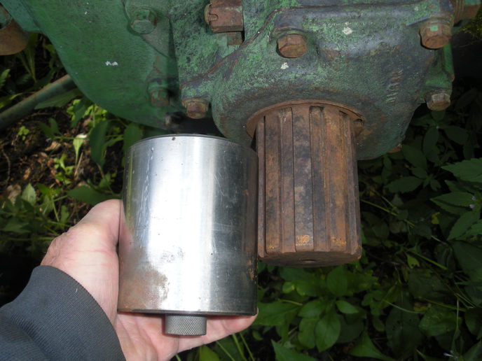

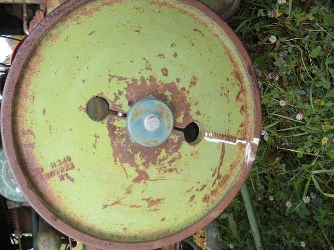

My son bought a 70 diesel and we got the manual for it today. The pictures show a flywheel with pinch bolts to tighten it on the crankshaft. This tractor has a taper lock but the flywheel is solid. it doesn't have the pinch bolts. Do they supply a whole new flywheel when you buy a taper lock or is this flywheel actually off something else. It seems to me that the flywheel needs to go on farther. The square for tightening the taper lock is only half way on when it is tight.

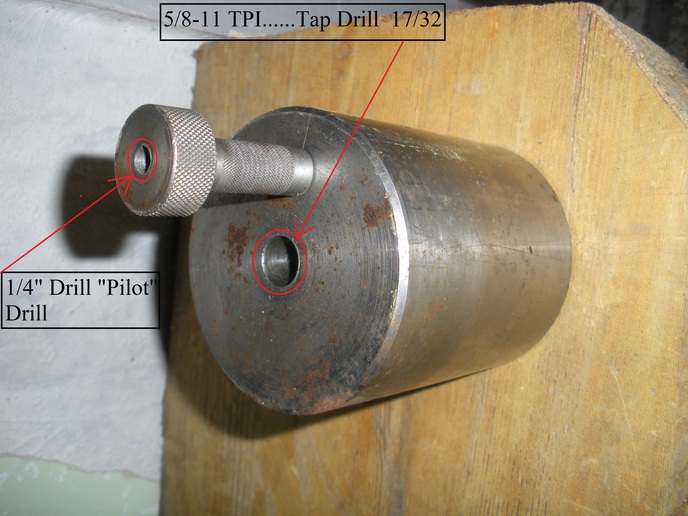

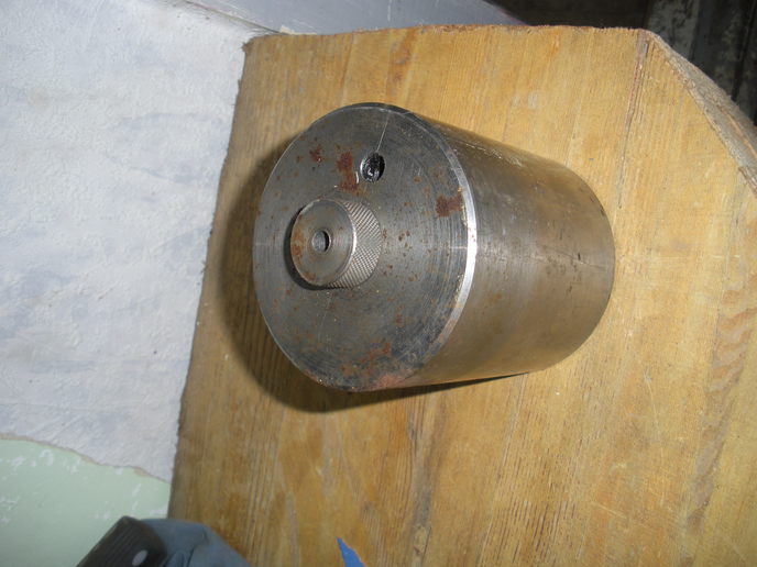

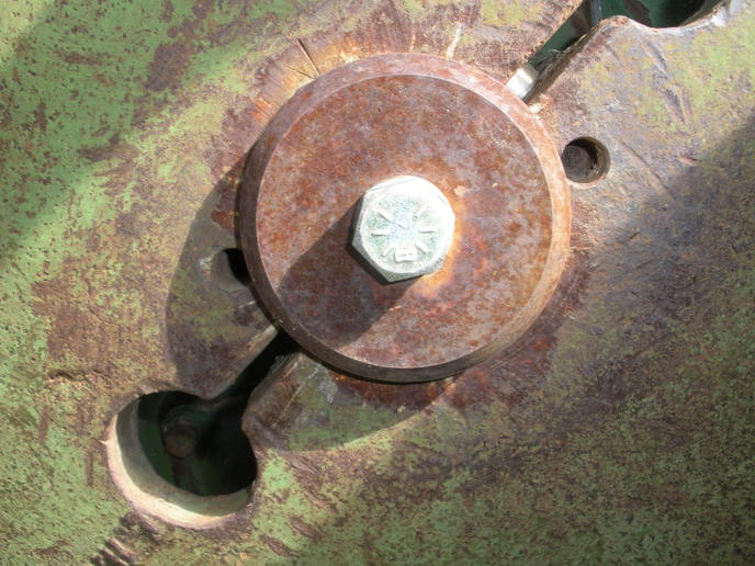

John Deere D
11-09-2019 09:47:25
Report to Moderator
 Re: John deere 70 diesel flywheel in reply to Jim Pollock, 11-09-2019 04:40:45
A tool I built so as to drill accurately the end of several styled JD "Ds". Tapped and threaded to 5/8 11 TPI:
Shims are placed between the end of the Crank, and the RETAINER WASHER and or between the FACE of the RETAINER WASHER and the FACE of the FLY WHEEL:
Flywheel cannot move linearly ...
Jim,
That spacer is just a piece of pipe that just fits over the crankshaft and it measures 3 1/4 inch if I remember correctly, check manual to be sure. Go to your your local plumbing supply store and have them cut one for you. I bought a new original nut to hold that spacer and cleaned the crank treads with a stiff wire brush. Be sure to block the crank to the left when adjusting the end play with clutch engaged. As Blksmok said the slinger maybe too worn to get the proper adjustment without being replaced. Sometimes Sharpes has some good used ones at a reasonable price. If I remember correctly the big square nut seemed to go on far enough . Remember the collet needs to go on first and slide it on till it hits as shown in my pics. Then the flywheel goes onto the collet by hitting the large surface with the biggest sledge you can find, think I used a 12lbs, 16 lbs is recommended . Hit it just ONCE, then tighten big nut using a huge pipe wrench. You might want to contact "Blksmok" from this site as his knowledge of these tractors is best IMHO.

4010 puller
11-09-2019 07:35:12
Report to Moderator
They come with new flywheel and the hub that slides on crank.it takes a little time setting crankshaft endplay , and a lot of hits with big sledgehammer, hit flywheel one hit at a time alternating sides and snug up big nut every time you hit it
