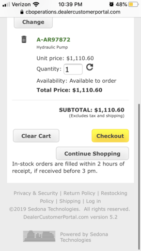

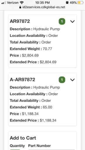

Looking for options again or still ? Seems most of the aftermarket ones are around 970$ found a site with rebuilt ones for 650$ plus 300$ core seems like a decent price if they will credit you for the core ? Oem Is a lot of money probably can?t go that route
The local hold em n screw em Is a little higher like always on the exact same part I don?t plan on buying from them
