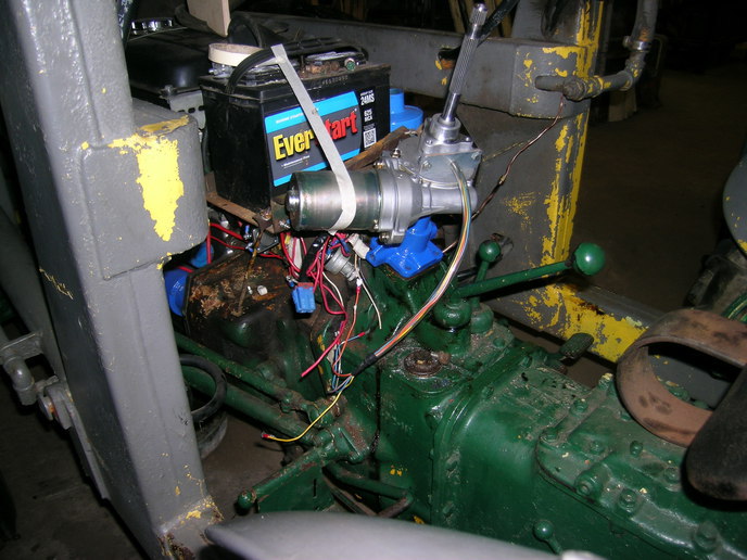

To start with the steering system has been installed at this time. I am finishing the wiring right now.

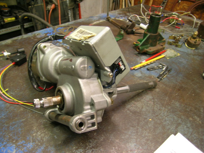

I started thinking about installing an EPS (Electric Power Steering) system after trying to drive my tractor around the house. So, I Google d ?electric power steering? on the internet.

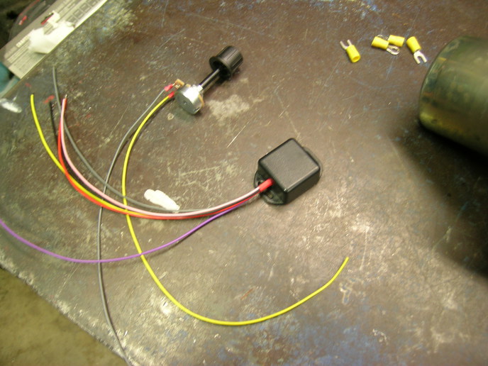

What I found really excited me so I read everything I could find on line about this subject. I checked ebay and found the steering unit that I am using now. My unit is out of a 2005 Saturn Ion, normally you would need the computer out of the Saturn to help operate the EPS. But there is a small control and rheostat that is listed or ebay that will operate the EPS and it is listed in the same area that the steering units are listed.
My unit cost me $130.00 and the control cost about $70.00. The control comes from Portugal but don't worry this guy ships the controls right away. He will also send you a complete set of instructions.
My control took 4 or 5 days to get to my mailbox.

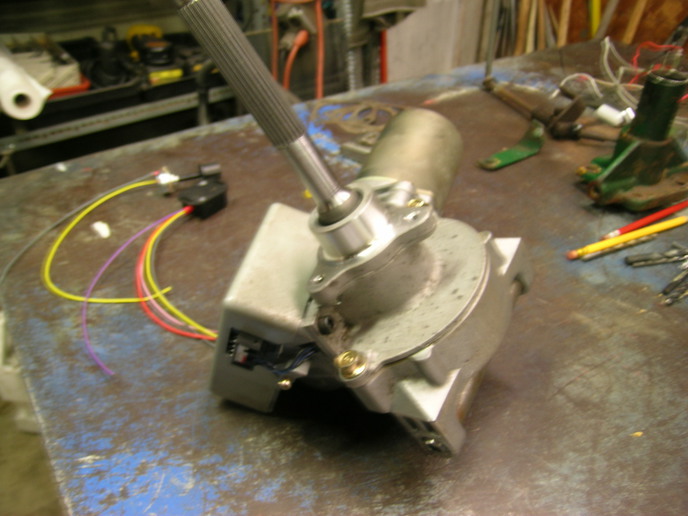

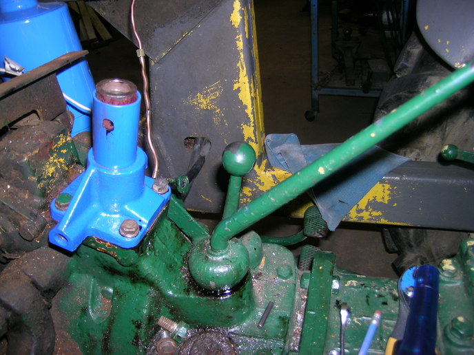

To start the alteration I removed the the steering wheel and the complete dash housing. Next the steering column was removed from the top of the transmission. The steering rod and screw was not removed. At this time I sucked the old fluid out of the steering box and installed about a quart of new 90 wt oil.

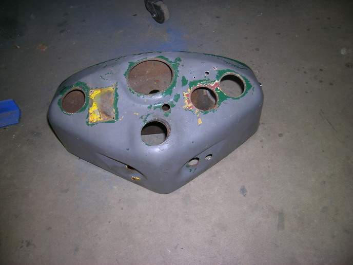

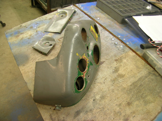

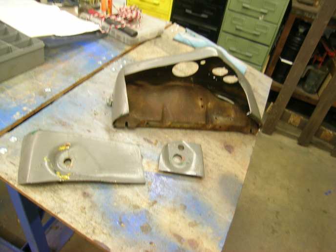

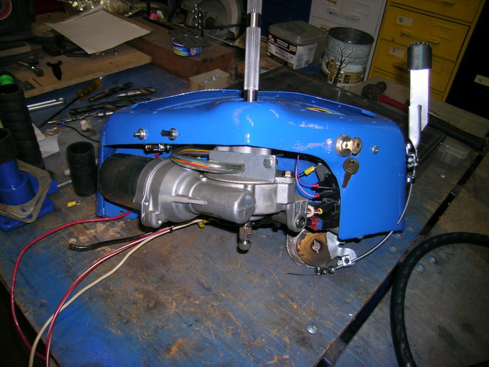

I will be altering the dash or cowl or whatever you may call it on my old tractor so I can install an Electric Power Steering (EPS) system.

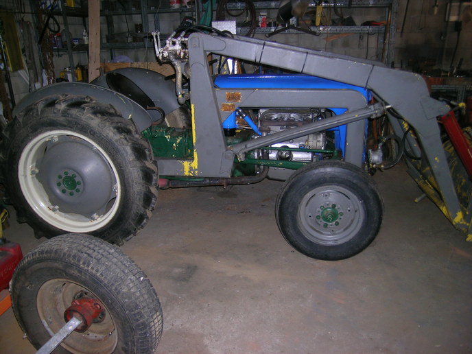

I knew the tractor steered hard when I bought it but I never realized it would wear me out in such a short time. My tractor has a front end loader that adds a lot of weight on the front wheels therefore making it hard to steer.
This project took me about 3 to 4 weeks to complete. I started looking at some old used power steering systems that were on other tractor. I decided I wasn't going to spend the money for
a labor intensive and high maintenance hydraulic unit.
I goggled EPS and I found some 2002 to 2007 Saturn EPS units and a video on how they installed their EPS.
I will be writing in this post and adding pictures as I get time, please bear with me.
First thing is for me to learn how to post pic's on this forum.

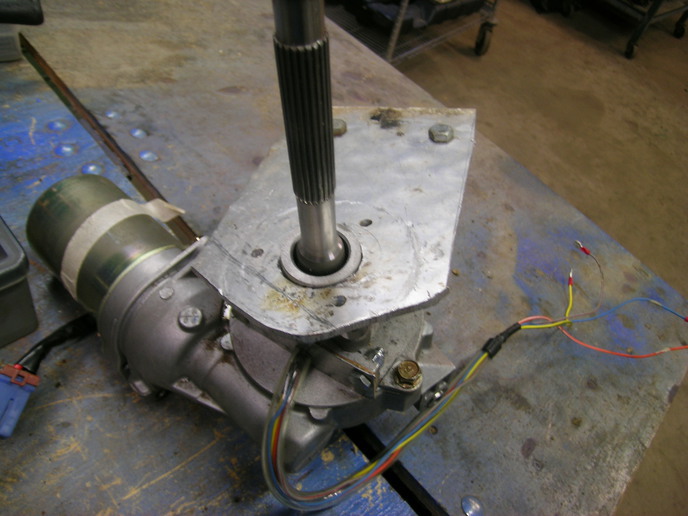

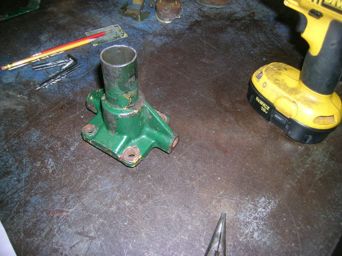

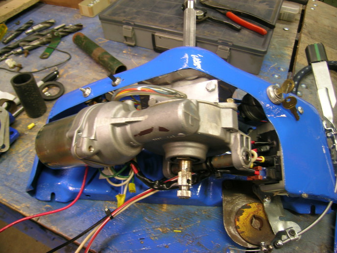

Next, there were two dash housing supports that connected the dash to the steering shaft housing. I used the right support which also held the choke rod, made it longer and bent it to fit to help support the dash housing.
On the left side I just made a new support and bolted it on. This made the dash housing very sturdy.

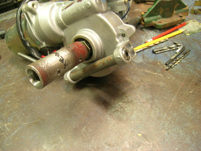

Both supports are bolted through a steel tube that is manufactured in the steering unit. See the last picture, the tube is just under the output steering shaft and above the sleeve lying non the workbench.
The next step is the steering wheel.

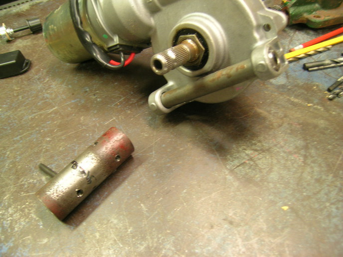

The steering wheel attached to the old tractor steering shaft by way of a tapered hole and key way. The new steering shaft has splines and the OD of it is .625. The steering wheel was bored out to remove the tapered hole, that made the ID of the steering wheel .812. I next turned a sleeve with an ID of .625 and an OD of .812. The sleeve was pressed into the wheel and tack welded on one end.
I wanted to make sure the steering wheel was nice and tight and not wobbly. So I welded two .375 x 1 inch x 2 inch pieces of steel to the outside of the steering wheel hub. I then cut out a .250 slice between the two pieces of steel. This makes the hub a clamp that will grip the steering shaft. Since there are no splines in the hub I drilled a small hole through the hub and shaft and tapped in a roll pin.
I added a piece of 1.5 inch ID fuel hose on the steering shaft below the steering wheel.

What is the name of the control and rheostat you bought?
RH
Is there any reason you cant just tap power off the battery at the proper polarity?
If the steering unit has a "hot" and a "ground", you should be able to do that. If it grounds thru the metal case, then this method wont work.
I have one question about your set up for EPS. You do not list having a electric control unit, ECU, literature for my ESU states the EPS controller sends info to ECU according to the position of the knob on the EPS controller. How do you solve this problem?
I plan to use EOP unit form Nissan Sentra
