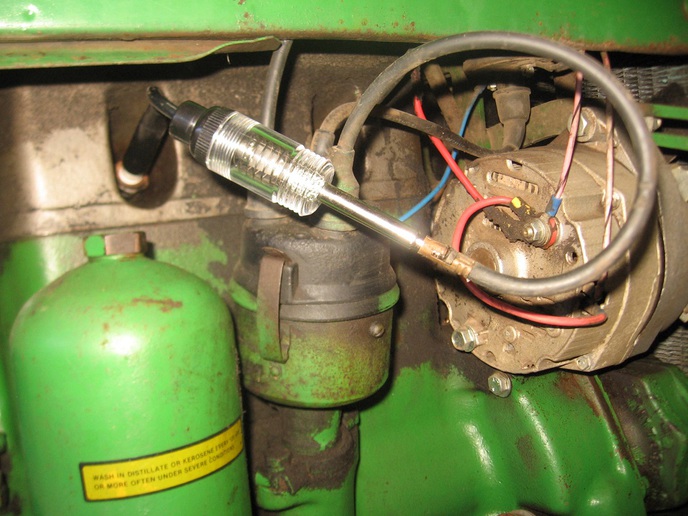

I have a 1949 MT. It has no spark. Here’s the back ground...it has not been run in 4 years. It rolls over fine. I put new, points, condenser, cap, coil on. I am not getting any spark coming out of coil using in line spark tester. Shouldn’t I be? With the cap off I am not seeing any spark at points either. Any help on what to do next would be great I would like it running! Thank you in advance.

"I am not getting any spark coming out of coil using in line spark tester"
Take a look at the photo below.
If the in line spark tester does not flash as the motor turns over, then you might consider checking both terminals on the coil using a test light.
Turn the ignition switch to the LO CHARGING position.
Next check the NEGATIVE terminal for power coming from the ignition switch.
If the test light shines, then there is power to the coil; otherwise check the ignition switch and/or the lead wire from the ignition and accessory terminal.
Next check the POSITIVE terminal for power from the coil.
If the test light shines, then there is power through the coil; otherwise replace the coil.
Next check for power at the distributor terminal stud.
If the test light shines, then there is power from the coil; otherwise repair/replace the lead wire to the distributor.
Next check for power inside the distributor.
Note the stud terminal bushing.
Next check for power at the terminal stud inside the distributor.
If the test light shines, then there is power from the terminal stud to the points; otherwise check the stud terminal bushing.
Next check for power from the points.
If the test light shines, then there is power from the points.
"With the cap off I am not seeing any spark at points either"
Check the points gap and adjust to .022 if necessary.
Please be mindful of common safety steps; expressed or not.
Crank the engine and check for spark at the points.
If there is a spark when the points OPEN, then the primary circuit is working; otherwise you might consider replacing the condenser.
We have one MT that has gone through many condensers; even new ones.
In regards to the coil, you might also consider checking the coil wire to the distributor.
Hope this helps.

Thank you everyone for your help and pictures. I replaced the wire from the coil and cleaned the connection. Cleaned the points again and it started right up!
