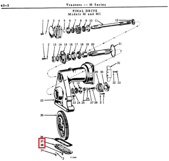

I am cleaning up a 1948 M that has sat in the shed for 25ish years. The inside of the transmission housing is lined with black slim that does not wash out with a diesel fuel flush. There is a port on the back wall that goes into the diff housing, so likely the same slim is in there too. What would be the best way to visually inspect the diff and to flush it out?

hotflashjr
05-15-2019 06:51:58
Report to Moderator
 Re: JD M in reply to donjdm, 05-14-2019 12:22:19
I have been into the final drives on a MT, which is a bit different, but unless you had multiple failed seals and gaskets and an overfilled transmission case I cannot see how it would get into the final drives. On the final drives pop off the bottom covers, get new gaskets, clean up the services with a wire wheel and use some Indianhead gasket shellac or the similar and then fill with new gear oil. You may end up with some additional leaks from the final drive quills but I usually wait until I see those leaks to mess with those because they have shims behind them to set the right clearance on the bearings. I have not had luck getting those to re-seal properly.

James Howell
05-14-2019 11:32:06
Report to Moderator
 Re: JD M in reply to donjdm, 05-14-2019 09:27:35
"What would be the best way to visually inspect the diff and to flush it out?"
Take a look at the FINAL DRIVE diagram below.
Note the final drive pan (Key 37) and pipe plug (Key 38).
Take a look at the photos below.
Remove the final drive filler plug and drain plug.
Once the old oil has drained, replace the drain plug.
Add approximately 3 1/2 pints of diesel or other cleaner level to the filler hole.
Take a ride around the farm, then drain the diesel/cleaner.
You might consider removing the final drive pan to visually inspect the final drive.
Hope this helps.
