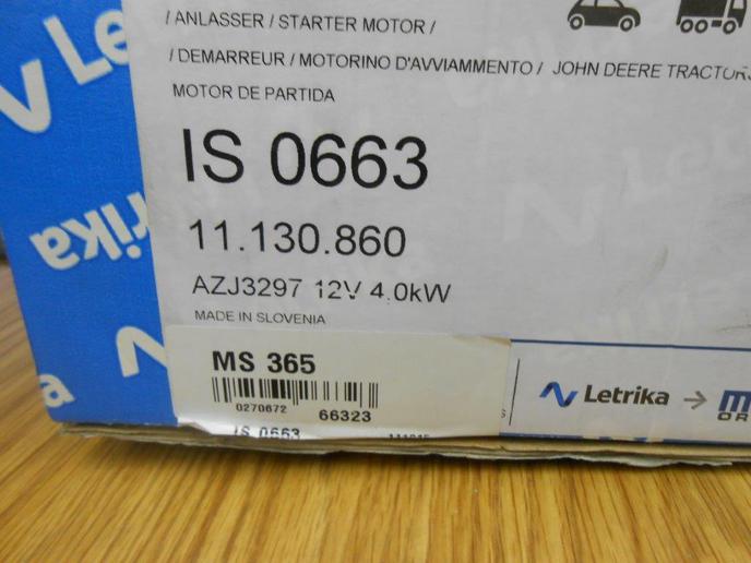

Good day!
The 12V starter on our '65 3020 is getting pretty soggy so before it completely packs it in I'd like to round up a replacement. That said, I'm curious as to the aftermarket options that are out there?
I found that Tim S. had mentioned the Iskra IS 0663 sometime ago. Just wondering if you're still happy with those starters?
TIA

The gear reductions can be a mixed blessing . Gear reductions in general tend to have more torque but less cranking rpms than a typical direct drive . The PM gear reductions are a little bit faster than the traditional gear reductions with energized field windings . The Iskra as shown is the best all around starter for the 3020. 4Kw is the level of power that should be installed . Bigger is better.

Tim S
05-13-2019 14:55:00
Report to Moderator
 Re: John Deere 3020 12V Starter Options in reply to Glen D Anderson, 05-13-2019 14:35:18
Yes, that is a 12 volt starter and it's short enough to work well on the 3020. and Solvenia is way better than China

Is that gear reduction?
