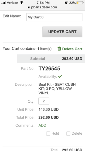

Should be the same part numbers for all 3
according to the parts books 146.30$
