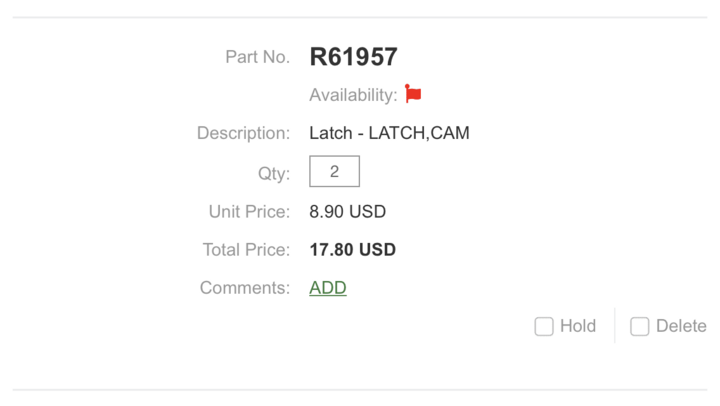

Could I trouble you for PN info? I'm not sure that my local JD dealer would even know what a 3020 was as they primarily deal in lawn mowers and the toy tractors.

 Re: 3020 resto progress and remote hydraulic coupler questio in reply to thastinger, 02-12-2019 19:34:31
Part number is in the photo and then a parts breakdown of the coupler the chains hook underneath plate number 30

I actually saw where those adjustments were located while reading the operators manual today. I went to the JD parts diagrams and was able to locate the broken piece of my coupler so I ordered it and a rebuild kit for them, hopefully that will get her all fixed up.

John Deere has an updated latch that goes where that bolt in the center of the coupler is and it holds the levers from moving as easily when you have hoses plugged in
